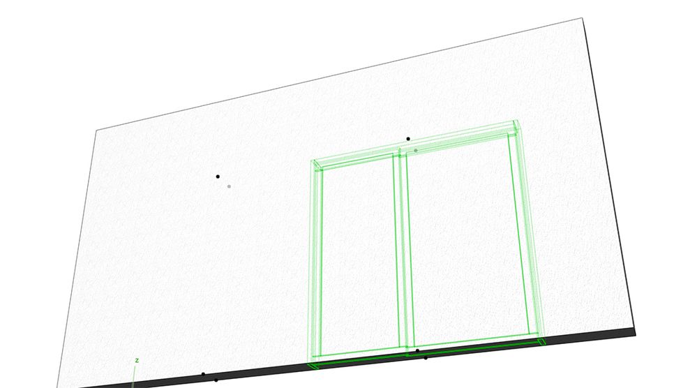

I have two more questions:
1) any ideas on why my wall hole does not show up in 3d? I have scripted a wall hole as:
WALLHOLE 4, 2,
0, 0, 15,
A, 0, 15,
0, B, 15,
A, B, 15
but don't get an opening. See attached image.
2) why would the door offset from the wall hole hotspots in both 2d & 3d? I have tried including an ADDx line to both scripts and it has no affect. Seems like starting from 0, it should align w/ the door script, or do wall holes measure from centerline?
WALLHOLE 4, 2,
0, 0, 15,
A, 0, 15,
0, B, 15,
A, B, 15
In the local coordinate system of the Door the 0, 0 coordinate is the middle bottom point of the Door. The Door extends both to left and right equally.
So the Wallhole definition show be like this:
WALLHOLE	5, 2,
			-A/2, 0, 15,
			A/2, 0, 15,
			A/2, B, 15,
			-A/2, B, 15,
			-A/2, 0, 15
It may be a better idea to close the polygon, thus the 5 nodes instead of the 4 (I am not totally sure about this, I just looked at the examples in the GDL guide.)
But an even important point is that when the WALLHOLE is rectangular, you do not have to specifically script it because the Door will automatically cut a rectangular hole for itself from the Wall by default. You need to script a Wallhole only if it is not rectangular.

Thanks Laszlo! I was referencing the link from the GDL center, but did not understand the door/window nature of originating from the center of the opening. So I think I need to rewrite the script to base off A/-A instead of 0,0/A.
I thought if I had a manual WALLHOLE I could offset the wall hole to match my script, but that doesn't translate well to the plan projection (back to the original question of PROJECT2{2}); unless I have a WALLHOLE2 also.
Ok, I think I found the easy solution. Just a simple:
ADDx -A/2 !at the top of the 3d script window
I had to modify my transformation stacks a bit, but everything is in the right spot now, plan and elevation!

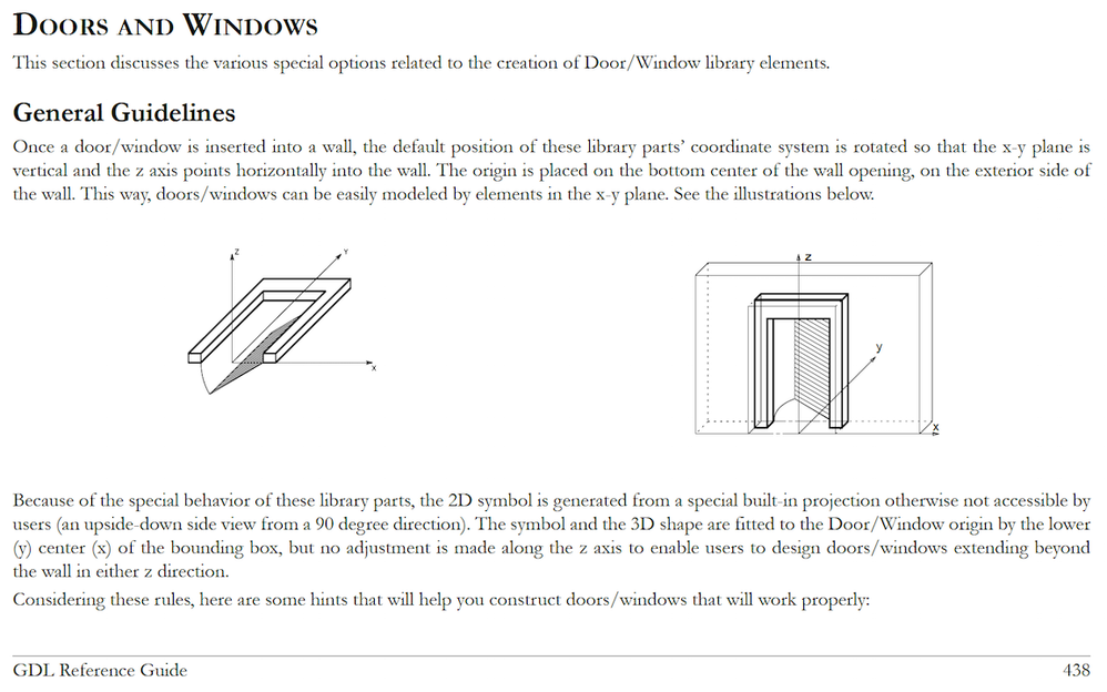

David Maudlin
Rockstar
DGSketcher wrote:
David: "5" is not listed in the GDL manual and therefore I assume a risky option. Normal top view would be PROJECT2 3,270,2 is there some trick in using "5" ?
Doors and windows are created at a 90˚ rotation to their placement, so the "3" projection_code shows the face, not the top, of the door.
