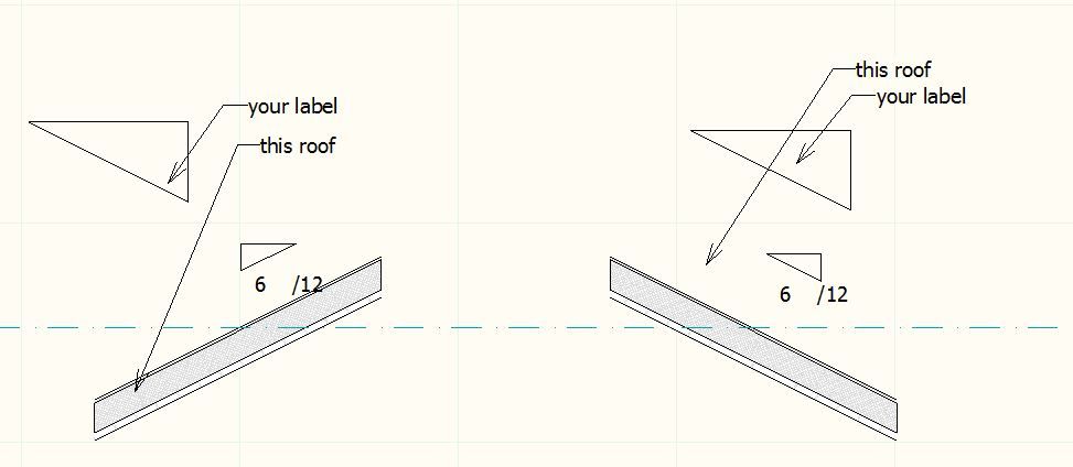

If anyone can find the time, have a look at this label - it works in the plan
window and differently in the elevation window -- however I cannot get it
to sense the direction of the roof plane -- I have put in a flip command but
think it would be much handier if it could sense the correct direction.
Any ideas or advice ????

RandyC
Cosminn
Here is a section showing its behavior in elevation window --
doesn't appear to flip the label
undefined

Cosminn
Hi, sorry for late reply.
Is that a multi Plane Roof?
If yes, then agree with you, will not work. If you split that roof into single plane roofs. then should work.
Sincerely,
Daniel
RandyC
Sorry , not a multi plane roof
- could it be that it will work as a library part
but not as a Label?
undefined
ArchiCAD 4.5 --- 27 , Win 10 , dual monitors, 64 gb ram,Nvidia GeforceRTX 2080 TI, I-9
Cosminn
You are right RandyC. My Bad.
It's not working. I think I was in Hurry. Will think on this, good post.
