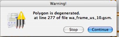

I instaled the new SE Library, now when trying to generate any section or elevation I get the error Ploygon is degenarated @ line 277 of file wa_frame_us_10.gsm.
Can anyone guid me on what object it maybe so I do not use it for now?

Joseph wrote:more often than not, a Polygon Degenerated error means that some parameter, somewhere in the object is set to 0.... finding it is not always so easy!

I've seemed to have solved the SE Library error. It has to do with the Walltype parameter in the doors and windows. When I switched it from "Stud Wall with Siding" to "Stud Wall" the error went away. Maybe it has to do with using/not using composite walls? Or just a bug...

We saw this same error with a wood window object when we set the ganging above checkbox on, but with 0" spacing to the window above.
