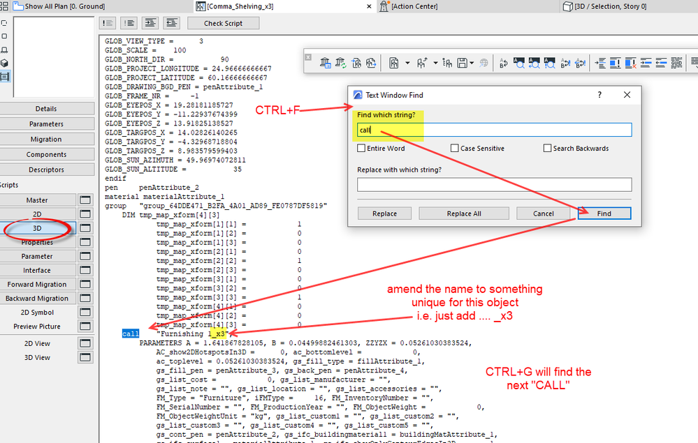

OK, I have got it, but you are going to have to do a little GDL editing.
It seems the same names is causing a problem.
They are all unique parts but Archicad is still getting them mixed up (it is a bit hard to explain why, so I won't).
Solution is to re-name the parts (macros) so they have unique names.
You need to do this for the files them selves and also in the main object script.
Select the 3xshelf object and open its script (CTRL+SHIFT+O is the keyboard shortcut).
Now go to the '3D script'.
Press CTRL+F and type ... call ... in the search.
Press "Find" button.
Alter the name of the macro (part) it is calling - I just added ... _x3 ... to the name to match the parent object.
Press CTRL+G to go to the next CALL and change the name there as well.
Repeat until there are no more to do.
Save the object and close it.
Now go to the library folder in your Windows Explorer and re-name the files there with the same names you used in the object script.
Now because you have renamed them, you will need to re-load the libraries with the Library Manager.
Once re-loaded it should all be good.
You can do the same for the x6 shelf if you want to or leave it as you have 2 completely different sets now.
But if you import other furniture with the same names, you may need to fix them up as well.
Basically all the parts should ideally have unique names as well.
