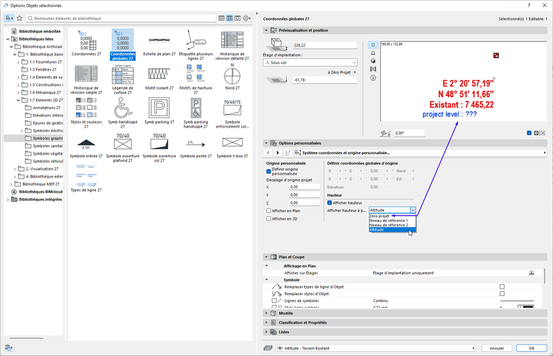

I placed several instances of the global coordinate objects. When I schedule them, I get only the Z value corresponding to the settings I selected in the objects.
I have a problem and a suggestion :
Problem: Why are X and Y values aren't displayed in the schedule? (
Suggestion :
What should I add to the object script to show in plan the Z value referring to Sea level AND underneath the Z value referring to zero project ?

If you converted it from a 2D symbol to a 3D element, even if it is invisible in 3D, you would then just be able to autotext pZero?

yes i can label it and show the Z value with autotext, but in schedule , it doesn't show the value

The complicated route then would be to REQUEST your Home Storey and your Storey Structure. You can then use these values together with ZZYZX to calculate pZero. Once stored in a new Parameter you should be able to schedule it.
