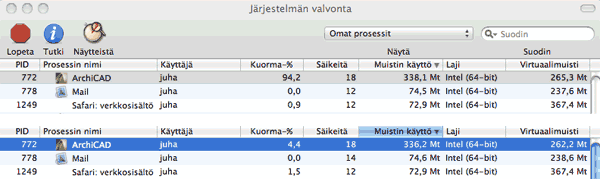

The picture below shows memory consumption. Upper one happens
when changing between windows.

Yep, switched to INT version of v16, no slowdown!
Hello pejotu,
Thanks for the tip. I must abandon the FIN version for a while.
