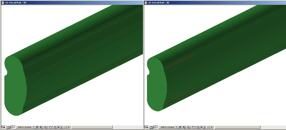

having an issue with masking codes to get a prism to smooth on the right faces.
Trying to make something like this: http://www.intrad.com/product97372/rcr-125.aspx
It's a shape with 3 main curves on the visible side. I want the object to be smoothed, except at the two creases where the curves meet (as indicated by the red lines in the screengrab).
Alternating between masking codes of 15 and 79 seems to either fully smooth or fully facet the whole object. Is there anyway to specify exactly which edges are smoothed? Changing the 4001s or 900s doesn't seem to affect it.

Any suggestions, or am I asking the impossible? A last resort is to add in an extra 'straight' face between the curves, but that increases to polycount so I'd rather not...

You will need to add two more planes for the straight faces (use status code 15), the code you have (which looks like it was generated by ArchiCAD) is all center points (900) and arcs (4001), with a few start points (79 or 15). I wouldn't worry about the few extra polygons, as under the standard resolution (36) your shape is generating more than 50 faces as is. If you want to decrease the polygon count, look at simplifying the back of the rail which shouldn't be seen in 3D anyway (unless you need this for accurate sections at a large scale).

David is right, GDL can not handle a rough edge between two curved surfaces.
You have to create a small gap between them, with a different status code (15).
Some exceptions, status code 128 for TUBE, TUBEA (AC12), and REVOLVE (AC13),
allow to get rid of these additional points (and polygons), for cross section profile.
This is a basic feature for any decent CAD/BIM software.
Unfortunatly, progress are slow.
	toler 0.0002
	put  0.0450,   -0.0481, 15,
		 0.0451,   -0.0481, 79,
		 0.0416,   -0.0389, 900,
		 0.0493,   -0.0329, 3000+79,
		 0.0653,   -0.0203, 900,
		 0.0653,    0.0000, 3000+79,
		 0.0854,   -0.0239, 3000+79,
		 0.0853,   -0.0240, 15,    ! rough
		 0.0854,   -0.0241, 79,
		 0.0139,   -0.0625, 900,
		 0.0854,   -0.1009, 3000+79,
		 0.0853,   -0.1010, 15,    ! rough
		 0.0854,   -0.1011, 79,
		 0.0653,   -0.1047, 900,
		 0.0653,   -0.1250, 3000+79,
		 0.0450,   -0.1047, 3000+79,
		 0.0450,   -0.0482, 79,
		 0.0450,   -0.0481, -1
