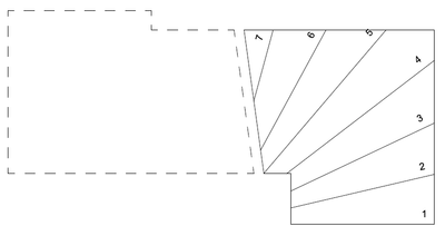

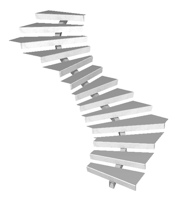

Upon opening my current project file, AC reports:
Invalid elements were found in this project!
and
The errors were successfully fixed by Archicad
It 'fixed' whatever the problem was by deleting the stairs from my project (!)
It had taken me quite some time to get those stairs right. Now it looks like I have to do the work all over again.

alexliz
Thanks, @Barry Kelly . I hadn't saved the file, so all good there.
I have gone nuclear - I now have four Archicad versions on my MacBook Pro:
27.0.0 v1 INT (3001)
27.0.0 v1 INT (5030) (this is 27.2.1 but, for some reason, the Finder on my Mac reports is as 27.0.0)
27.0.0 v1 INT (5060) (this is 27.2.2 but, for some reason, the Finder on my Mac reports is as 27.0.0)
28TP
I opened my project file in 27.0 (3001), ie the initial v27 before any Hotfixes applied. The project loaded fine, including the stairs. I copied the stairs to my clipboard, then started a new file (from New & Reset All) where I pasted them, then saved that new project as "Offending stairs v27-0.pln". After closing it, I reopened it in 27.0 and the only content in it, the stairs, load fine, both 2D and 3D.
I tried in all other versions and the stairs won't load.
This is now weirder, because I worked with this project till Hotfix 2.2, so it's very strange that now not even 2.1 reads it correctly.
At any rate, I opened the real project file in the latest Archicad, 27.2.2, and tried pasting into it the previously copied stairs from the step above, and it works. So I am now saving a copy of the project file to carry on forward.
Would you recommend I send the test project file, "Offending stairs v27-0.pln" to Graphisoft, using the Create Support Package from within 27.0.0 itself?

alexliz
Thanks, I will. To answer your questions:
  • Yes - as mentioned before, I copied the stairs from 27.0.0 v1 INT (3001) and pasted it into the opened project file while in 27.0.0 v1 INT (5060). Then I saved the project, closed, re-opened. It is working.
  • It's a simple staircase - see above.
  • I was able to recreate the stairs in 27.0.0 v1 INT (5060).

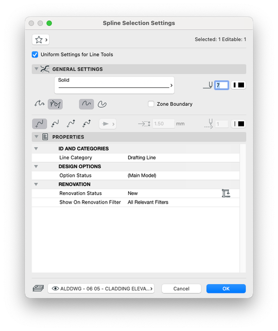

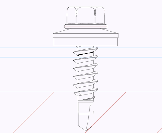

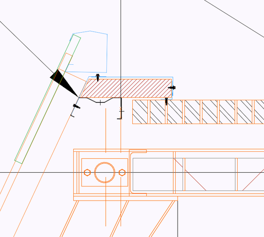

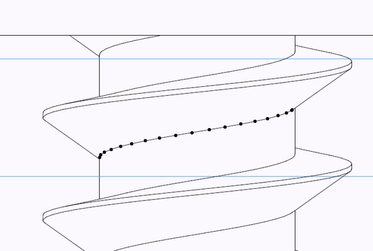

This has now happened with another project file - 21 Splines were deleted on this one.
I closed without saving, then opened the file in build 3001 and located the offending splines searching by the Unique ID which build 5060 had sent to my browser. I created a Module with those, then closed out of the file, re-opened it in 5060, AC deleted them again (as expected), then I merged the previously saved Module and they arrived right in place, no issues whatsoever.
I looked at their settings and can't see anything out of the ordinary with the 21 affected splines. They were among a great many other splines which arrived at some point into the project from structural engineers' Autocad - metal screws for structural steel and flashings. I wonder if AC is randomly mis-identifying elements which it must delete when opening them in 27.2.2 (5060).
I haven't heard back on the Support Package I created and sent yesterday. I'll post back here when I do.
Here are some screenshots on the splines from today - samples of the ones that Archicad deleted are selected below, among the truckload of similar ones which had absolutely no problem:

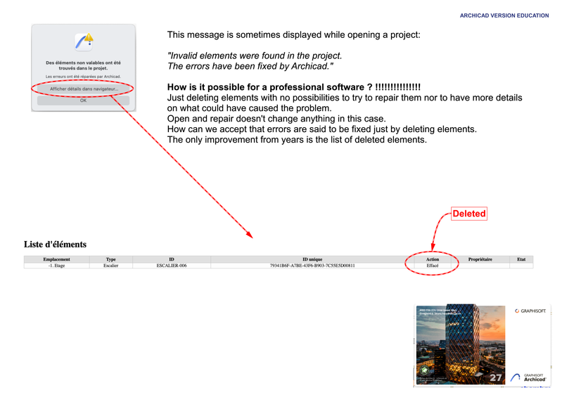

Hi Barry Kelly,
I have the same problem with some stairs and it recall me a long term question.
ArchiCad 3.43 to 28
MacOS Monterey
BrunoH
I try to open this same v27 version project with Archicad 28 and exactly the same message occurs with the same result.
