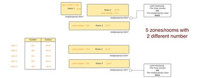

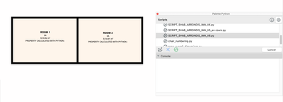

2 Zones, same zone number. The total value property is empty.

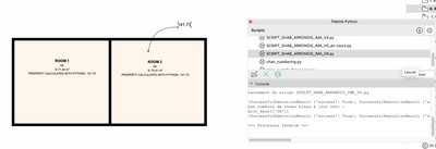

Launching the python script. The total value property displays the calculation.

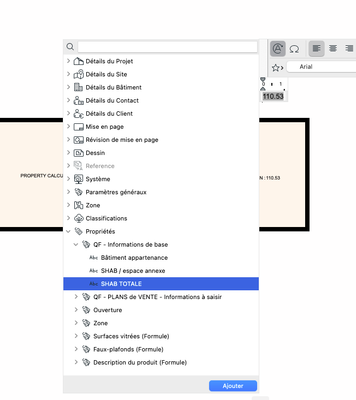

We link a label to the zone (normal Label) displaying the property Total value

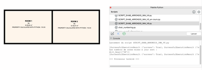

Each time we want an update, we launch the script. We can display the total value in a specific Zone with the zone stamp or with a Label.
