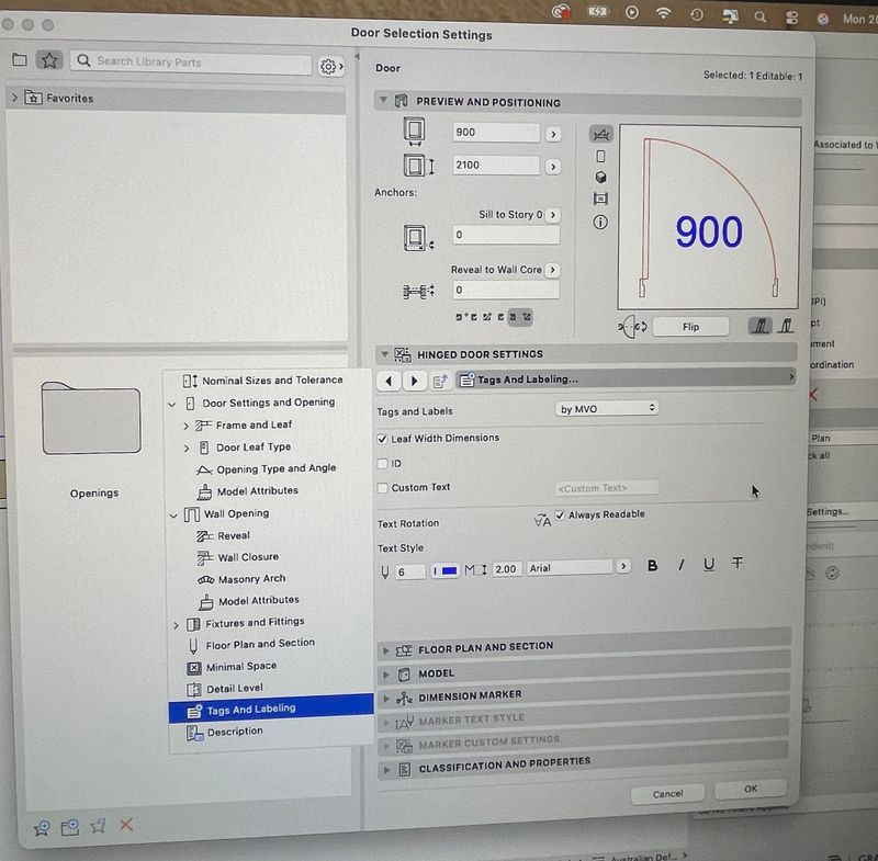

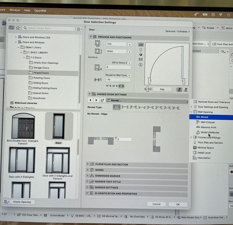

I've got 2 files open on the same computer.  One has "tags and Labeling" available in the door selection settings, the other file doesn't.  I would really love to put the leaf dimension on my plans.
- I have gone into the MVO and all the "markers" are checked.
- I am using a door from the ArchiCAD library.
- I have confirmed that both files have the same libraries uploaded to them
Now can I show the door leaf width, as per the first image if I can't access the "tags and Labeling" option?
TIA,
Sheena

Hi @Sheena42

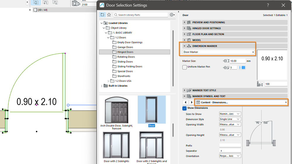

I cannot access to that Tags and Labeling option either, but you can try playing around with the various dimension markers available to achieve what you need.

Sheena42
Hi Ricardo,
Yes, I got this option to work, it just looks messy, I don't need the height.
I would love to know why one file template has the tags and labelling and the other doesn't.  There must be a way to switch it on or off.  I've noticed that there are other small options missing when I'm watching tutorials as well.

Lingwisyer
Guru
You can toggle the dimensions you want to display in the marker settings.
Ling.
ps. I have never noticed the tags and labelling tab till you pointed it out.
