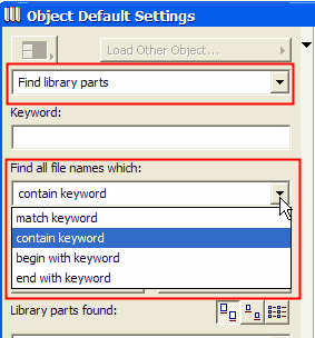

Karl Ottenstein
...Also, you can search libraries by name faster outside of ArchiCAD, and you can only do this if the library is extracted. I recommend that *all* PLA's intended for use as libraries be extracted."
I think this is bad and out-dated advice.
AC 9.0's object settings dialog lets you find parts very efficiently, with visual results. See attached. 😉
Karl
