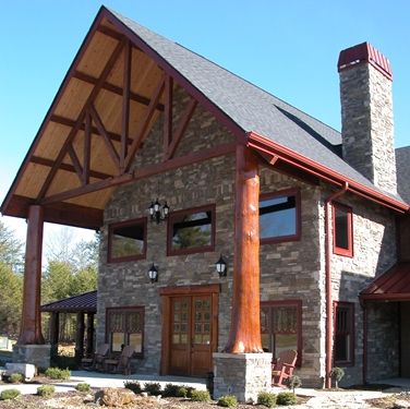

I'm looking around for an object that would look like the picture I attached. I need for the trunk to flare out at the bottom. I would like to be able to change the diameter to 10", 12", 14", & 16". And it would be nice for the flare to be consistent.
Does anyone here know of an object like this, or is anyone interested in helping me out?

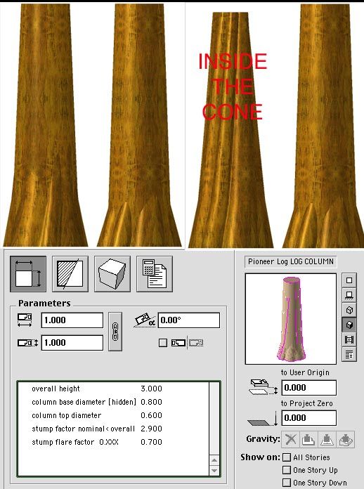

In a GDL object, you put a cone together with a poofy cloud shape. You SWEEP the cloud shape to taper/flare the root form into the trunk.

I think the RULED or RULED {2} commands can be used in GDL. You would have to define two curves that would be located on two parallel planes.
Maybe the Column should be modeled using two pieces: the upper piece is a round column, and the lower pieces is the one that would flare out.

Attached is embarassing code fragment to do the trick.
CONE hgt, brad/2, trad/2, 90, 90
MULX A/1.125
MULY B/1.177
SWEEP 25, 5,10, stmpflr, 62,
-0.407499, -0.322288, 1,
-0.258684, -0.382795, 900,
0.0, 167.2016, 4001,
-0.126969, -0.474765, 1,
0.106316, -0.375139, 900,
0.0, 164.996, 4001,
0.357439, -0.339304, 1,
0.271734, -0.030916, 900,
0.0, 119.2651, 4001,
0.498865, 0.194606, 1,
0.133436, 0.210387, 900,
0.0, 103.0921, 4001,
0.06603, 0.569892, 1,
-0.055944, 0.482556, 900,
0.0, 120.5257, 4001,
-0.193129, 0.543264, 1,
-0.260393, 0.40047, 900,
0.0, 120.4189, 4001,
-0.417588, 0.386176, 1,
-0.242902, 0.128576, 900,
0.0, 71.6359, 4001,
-0.542418, 0.043944, 1,
-0.369185, -0.100205, 900,
0.0, 119.9755, 4001,
-0.407499, -0.322288, -1,
0,0,0,
0,0,.2*stmpht,
0,0,.5*stmpht,
0,0,.8*stmpht,
0,0, stmpht

Thanks Dwight that was VERY helpful. I've already added to my drawing. Thanks again for the help that was beyond my GDL abilities.

The problem is NOT GDL.
That is an easy object to make - five variable, one object call (CONE), one command (SWEEP).
It was no challenge for you to place the code and create the variables in the script.
The problem is that do this you need to visualize the possibilities of such a limiting Geometric language and understand that objects can be inside another (cheating, to a purist) without blowing up the system. You also need to know that 2D shapes can be turned into 3D path instructions by subverting a script.

You can't make an irregular shape like that without understanding what GDL's Prescribed Commands can achieve, but it still requires imagination to put these seriously-limited form tools to work.
Another issue is finding a form generator. I used a cloud shape - a series of connected arcs - to make the bulbous roots - drawing them in 2D and converting the 2D fill code into a path. Just try doing that with polygon nodes!
