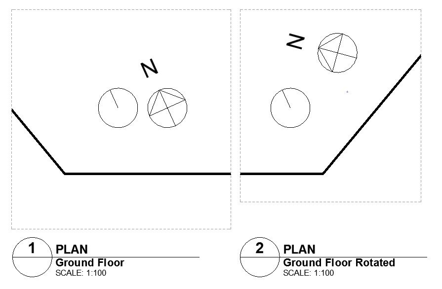

I'm putting together a new drawing title for the office. It's all GDL scripted and working pretty well so far. I'm trying to go a step further and incorporate a north point into the title which references the Project North point. ArchiCAD has a standard title that does this, however there's one problem I haven't found a way to overcome, the view orientation.
In the attached image the Arrow North Point is placed in the model space linked to the project north. In drawing one, the title north point matches it. However in drawing two when the view orientation has been rotated the title north point doesn't change.
Does anyone know if there is a parameter similar to the project north or drawing name that will call up the view's orientation?

Lachlan Green
Argh! That is so close.
That does return the view orientation angle. However it seems to only return the orientation of view the object is in. So in the model space, an object with that scripting will show the orientation value, as seen in Drawing 2 (Rotated 45).
However on a layout sheet where the orientation is always 0, it returns 0 (the orientation of the ‘view’ the drawing title object is in) and not 45 (the view orientation of the view the title is linked too) as it should in the drawing 2 title.
I'll play around and see if there's a 'drawing_view_rotangle' or something.
