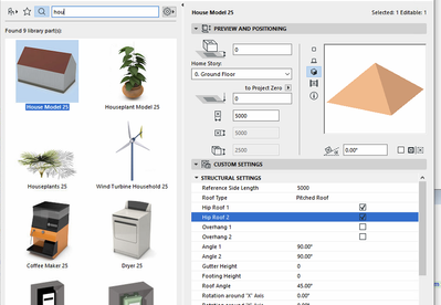

Hello,
Is there a way to use a label to calculate the volume of the built-in house model object?
I'm familiar with GDL is that's the only way to do it.
Juan.

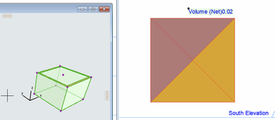

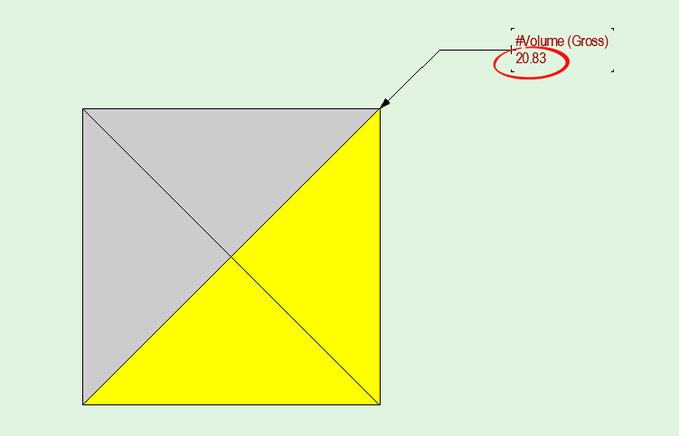

Sorry I forgot all about it.
It seems that it is calculating (only for NET volume) just the volume of the roof when you have a roof turned on.
With a flat roof and a 5.0 x 5.0 x 5.0 house, I get the correct 125m³.
But turn the roof on and it give just the volume for the roof.
I have no idea why it is doing this.
But as I mentioned, I didn't think you could get volumes for objects unless it is calculated in the object itself (which is not usual).
I did find this in the reference manual, and it conspicuously does not mention volumes for objects.
However, convert it to a morph.
It will actually create 2 morph elements (building and roof).
Union them together and you now get the correct volume (I think - I didn't actually calculate it).
But oddly I couldn't get the 'morph volume by storey'.

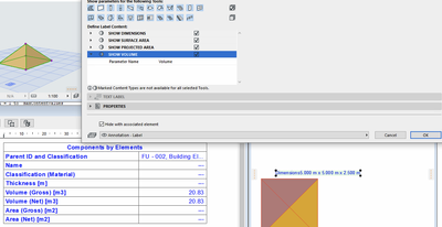

‎2023-06-15 09:20 AM
Thank you, there is something I don't quite get.
I'm using the dimension label which has an option to display volume, but the label is not displaying that information even though, in the schedule the volume is calculated.
Am I missing something here?
Juan.

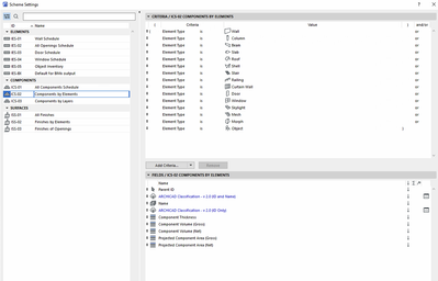

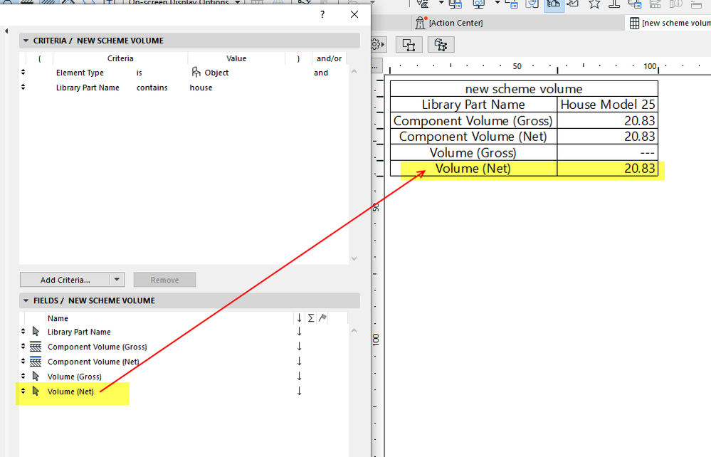

‎2023-06-15 10:25 AM
Yes it is.
Here is the Schedule:
Here is the criteria:
I hope these are the things you asked 😅
Juan.
- Mark as New
- Bookmark
- Subscribe
- Mute
- Subscribe to RSS Feed
- Permalink
‎2023-06-15 10:48 AM - edited ‎2023-06-15 10:48 AM
That is great, thanks.
This is strange.
You are using a 'component' schedule and 'component volumes.
The label can not use 'component. volumes, only 'general' volumes.
That is not the strange bit though.
It seems 'Gross Volume' does not work, but 'Net Volume' does.
I have no idea why.
So in your label if you use 'Net Volume' it should work.

‎2023-06-15 10:58 AM
Thank you, it is pretty strange, yes.
What lable are you using?. I'm still unable to display the volume.

‎2023-06-15 11:18 AM
Ok, there is something odd going on in here.
Is the volume calculating only the roof and not the whole object?
I got it working but things seems broken somehow.
If I set the roof angle to 0 the volume is 0 (normal thing), but if I make the walls high and the roof is still in 0, the volume is 0 😵
Juan.
