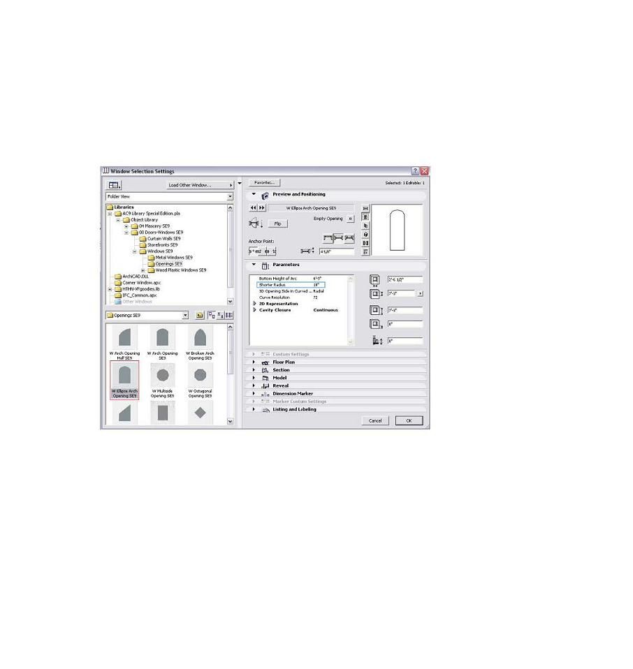

How do I determine what the larger circle is in an eliptical arch created from the w Elipse arch settings in the window tool?
As you can see in the atached, the W elipse gives you the "Shorter Radius" but it doesn't say what the larger radius is.
See 2nd post to see how I used to draw my eliptical arches in autocad.
In case anyone is wondering why I need this, it's because I need to show the dimensions and radius so my framer will create the arch properly.

Thanks, I could do that and I know how, but the W Elipse gives me the arch I am happy with, I just need that one last piece of info....the larger radius and It will save me a ton of time.
Are you saying there is no easy way to derive this radius from the W Elipse tool?

I think that the 'W Elipse' is giving you a distorted circumference (like a diagonal cut on a cylinder) and not something you can get by joining arcs of 2 radii.
On a section/elevation window you can play around with arcs and circles to produce a geometry sketch exactly like yours.

I've never figured out any real way to control it exactly.
