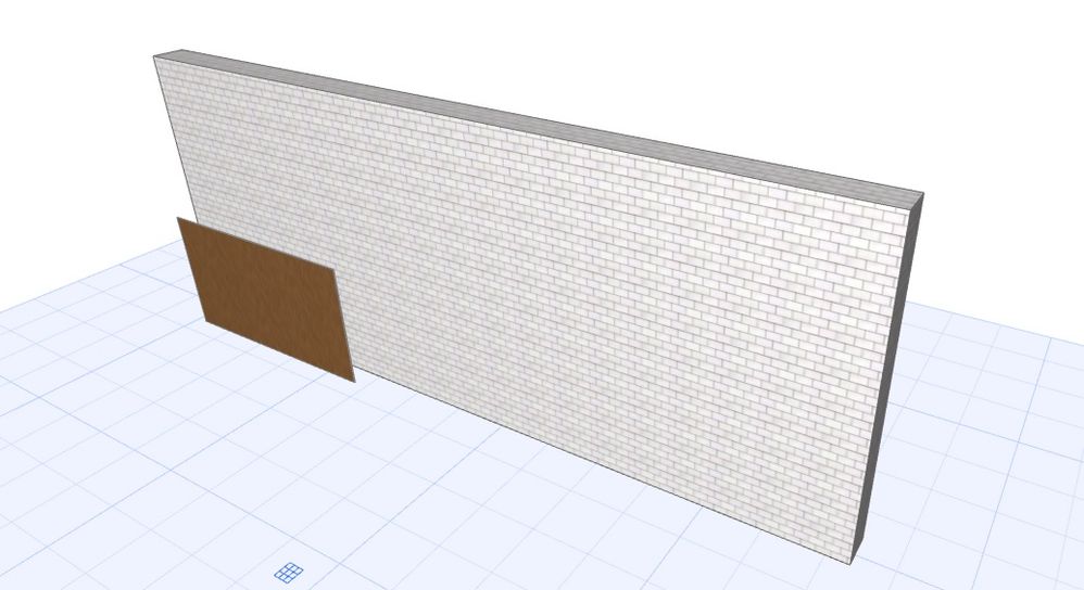

I have reached to the point shown in the attached image (not so much...), where I place the panel on the wall as a wall accessory but I really have no clue how to proceed in order to cover the wall with more panels of the same type... I think there must be a function or a way that makes it possible... but I don't find it anywhere. For the moment I'd be satisfied if I find the way to multiply the panels along the wall.

No idea I'll take a look!
I've finally achived to multiply the panel along the wall by looking some examples as Barry said.
Now it's turn to fit it to wall dimensions and holes...
I will keep on working on this little by little. Thanks!
