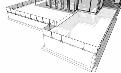

Hi everyone,
I’m new to Archicad (1 week) and would appreciate some help. I need to model a side-mounted glass railing system around a deck and around a pool (see IMG with to different arrange layouts). Each Option has a different layout, so the design requires different glass panel modules according to each segment.
Attached you’ll find the system reference and the proposed panel arrangement by length:

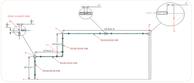

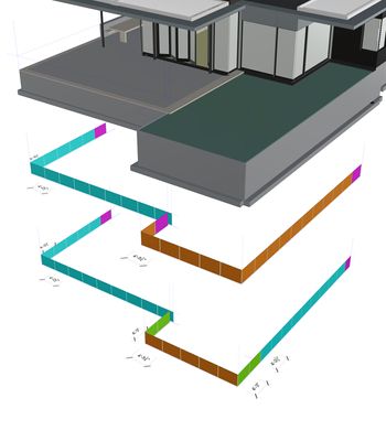

  • Teal: 4' 2 1/2"
  • Orange: 4' 5 1/4"
  • Green: 4' 3"
  • Magenta: Varies (depending on the option and how we want to address the endings)
What would be the best way to set this up in Archicad so the panels adapt correctly to each length? Should I approach this with the Railing Tool, Curtain Wall, or another workflow?

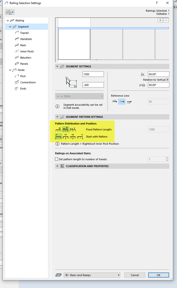

I would use the railing tool, as it is a railing.

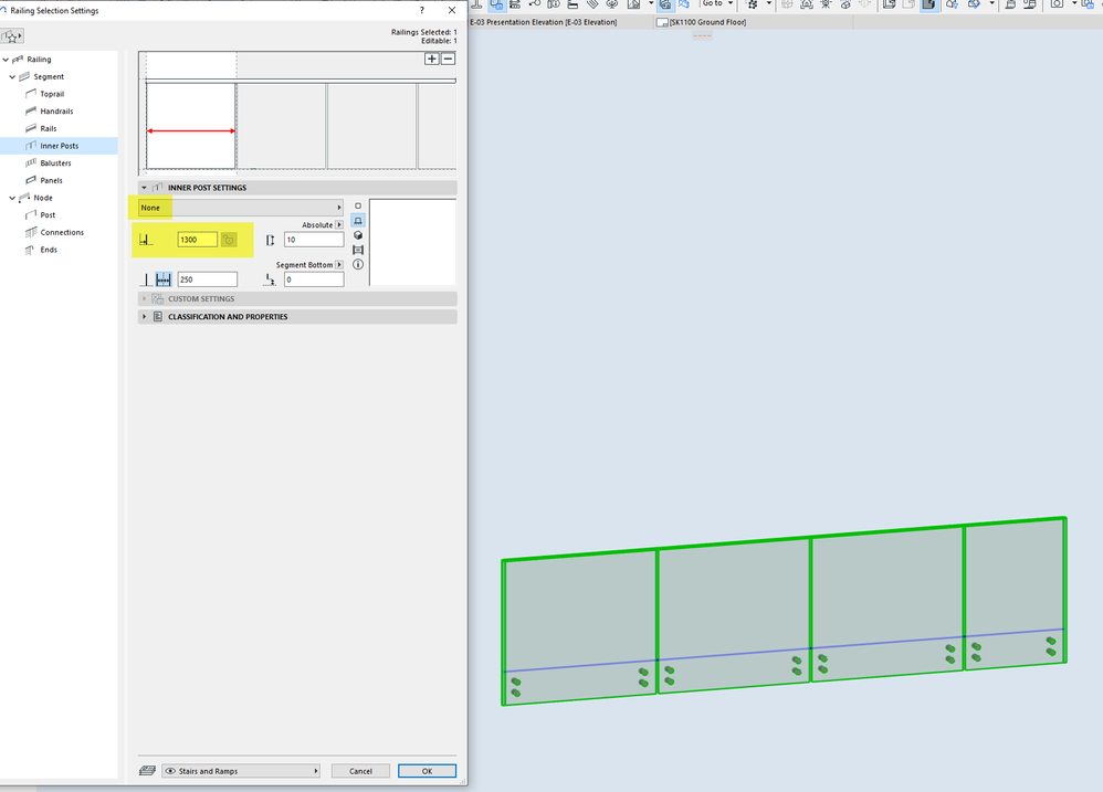

Set the inner post distance as your panel length, and set the post to 'None".
Then in the segment settings, make it a fixed panel length, starting or ending with a full panel.

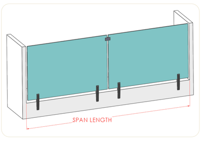

As for the panel fixings, you won't get what you show 'out of the box'.
But you could maybe use a short post with an offset to get something close.
See this post where I mention this and also links to another post where I have attaches a custom post object (still not exactly what you want.
https://community.graphisoft.com/t5/Modeling/How-to-model-glass-balustrade-with-spigots/m-p/622342

Given that it looks like the panels are the same design, just different widths, could you not just set a max length, a minimum distance from previous post or inner post, then just use your post positioning to size each segment automatically? This way you could have a single continuous railing without any custom segments.
Ling.
AG717
This is great, thank you for your patience and way to show this.
It was extremely helpful. I end up doing what you shared except for the for the fixing under panels. For, the brackets I model it as an object and just copied multiple time and then group (just in case).
