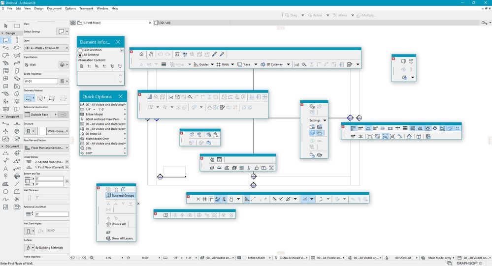

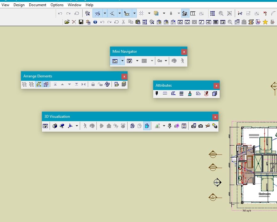

The pallets show titles but none of the toolboxes show titles anymore. See the colorful AC18 view and the totally bland AC28 version.

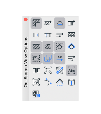

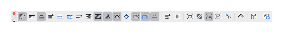

Here's what I see on a Mac for the on screen options toolbar... when fully horizontal, and as I stretch it towards vertical.  As soon as there is enough vertical space I see the title...   But, obviously very different from yours as the title 'bar' is always on the left for me... and it's on the top for you... which would make it disappear if fully vertical I imagine...  Odd.

The image you show with the titles is a really old version (18) as it has coloured icons.
The newer versions (Windows at least) don't have titles for the toolbars - the palettes do have titles.
I don't know of any option to turn them on - I think it is just part of the newer interface.

I think it is just the 'new' (monochrome) interface that does not have toolbar titles in Windows OS.
Even when I stretch to vertical as Karl showed, I see no titles.
