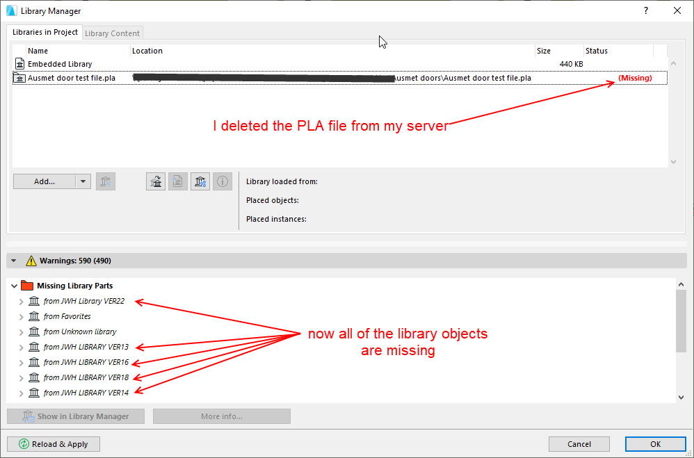

It is hard for me to say what has happened as I did not save the PLA file.
It should save a .PLA library as part of the file.
What is saved in that library depends on the options chosen when saving it.
In an experiment I just did, I saved the file I was working on as a PLA archive.
I am currently working in a version 22 file.
I saved with the option to save favourites (seems to be the default) and not the entire library.
Even then it did not save all of the favourites.
I got this message ...
And the result when I open the PLA ...
The missing favourites may just be a problem in my file.
I use custom libraries and not the default Graphisoft ones - so this coluld be a problem I have created.
However, notice there is a PLA library loaded.
If you now save this PLA as a PLN, it will remain the same.
But if you delete the original PLA file this library is linked to, then all of the objects will become missing, because you have effectively deleted the source library.
Or if you delete this loaded PLA library from the list, they will also become missing.
All of the old version missing objects is just because in my custom library, many of the old objects are from old versions and have not been updated.
Archicad seems to remember the version they were created in.
So to solve this I need to load the missing PLA file again, but if you have deleted it then you can not do that.
Or you need to load the old library that was the originla source of the objects, in your case the version 23 library (you may also need to load the migration libraries).

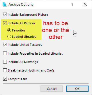

‎2024-07-05 03:12 AM
Including the loaded library should include the entire library, not just those objects used in the project.
It will be a much bigger file.
No harm in ticking all of the boxes (except for the bigger file).

‎2024-07-05 12:07 PM
The file will be large because you have archived the entire loaded library.
Usually an archive will have just the objects used (the 'favourites' option - not the 'loaded libraries' option).
The extra errors seem to be duplicates.
What ever libraries were loaded in the original project would have the same errors.
You can not save a PLA file back as the same PLA file.
Seems you can not even save a PLA file as another PLA file with a different name.
You already have the PLA file - there is no need to save it again.
You save it as a PLN file to continue working.
The idea of a PLA file is it is a snap shot in time.
You are not supposed to alter them, what is the point of archiving them if you keep changing them?
Just save a PLN and load the necessary libraries.
Archiving a file stores the used object (or entire library) so that later you can open the file and not have to fins the old libraries that were used for the job.
In 10 years time you may no longer have access to those libraries - the archive file solves that.
If you are simply sharing a file so you can work on it, just use a PLN and ensure you have the correct libraries loaded.
If you don't have those libraries, then get the PLA with the 'loaded libraries' included (as you have done), extract the libraries as you open the file and save as a PLN and continue working on it.
Every time you save the file it will automatically save as a PLN anyway.
You don't want to keep doing 'Save As' and change the file type to PLA every time you save.
Only do that when you want to archive the file again.
