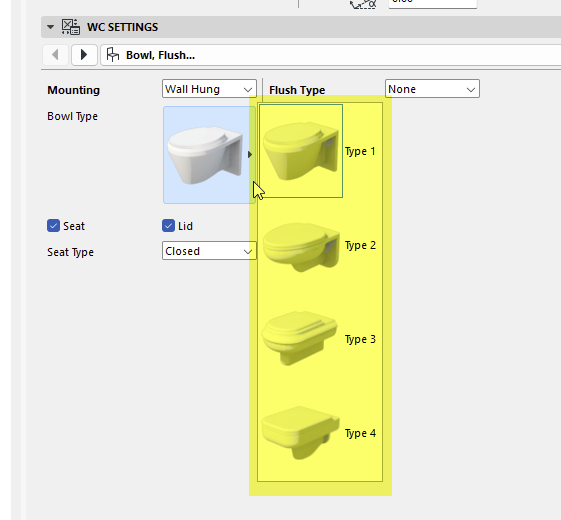

It is an option within the toilets:
2026-05-13 04:05 PM
As @Eduardo Rolon mentioned, the default WC object offers many interesting options for creating a pretty decent model of a public toilet; you just need to play around with the settings a bit.
You can also view other available objects by typing "wc" into the search box in the Object Selection Settings, where you'll find even more detailed ones.

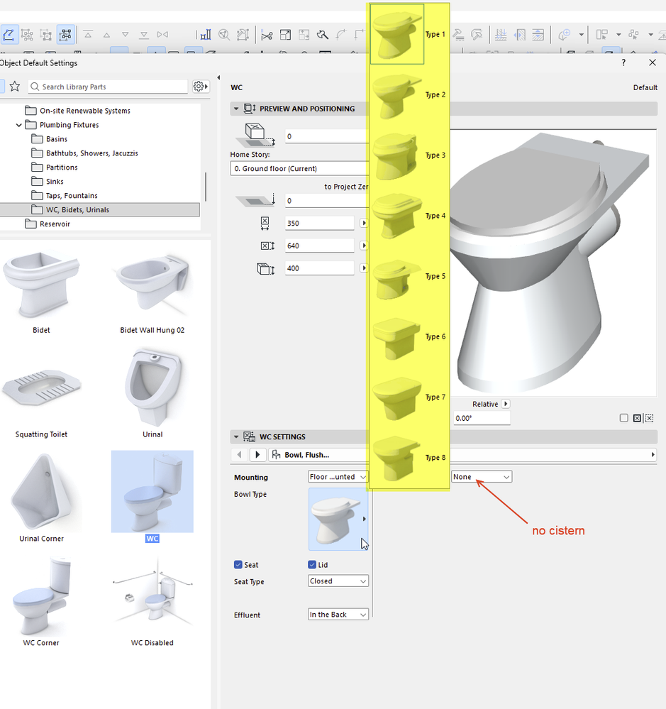

2026-07-22 07:55 AM
I am not sure what was in the US library in older versions, but it should be the same as what is there now.
There doesn't appear to be a USA plumbing library pack in 29.
These are all of the floor mounted bowls that I see in 29 - with the cistern turned off.
Then there are also wall mounted bowls.

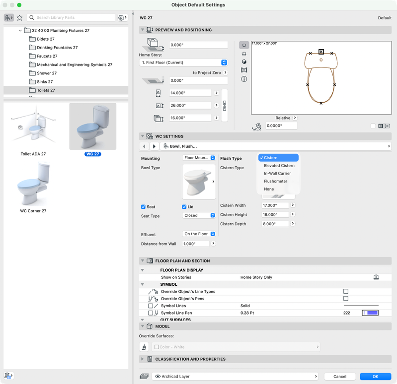

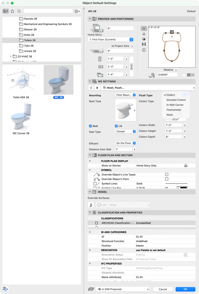

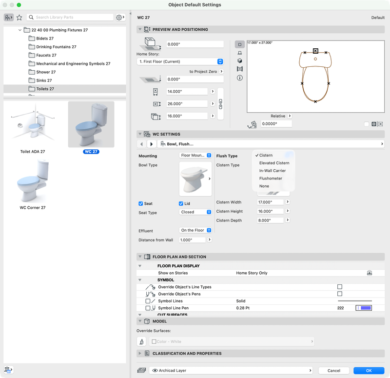

28 US has the same options as 29
27US too
As does 26 US
