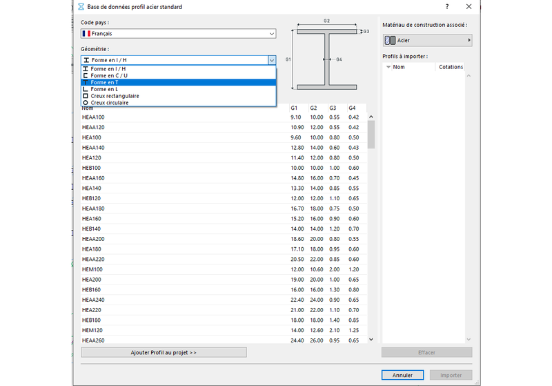

4 weeks ago
- last edited
3 weeks ago
by
I wonder why one still use objects (except for compatibility with older projects) rather than the standard steel profiles from ArchiCAD's built-in database. I find it more logical and flexible to use the column and beam tools with these profiles rather than objects.

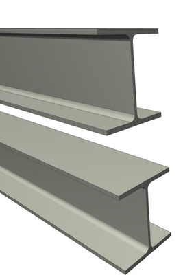

4 weeks ago
Because this is how they look in section and in 3d which is unacceptable.
CP on top
