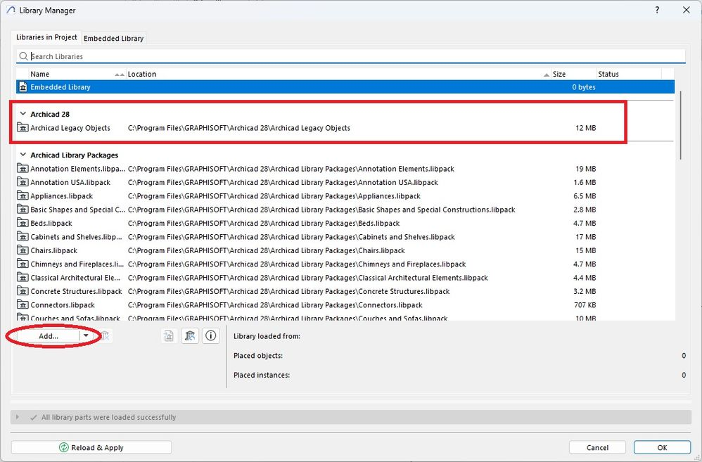

The library that came with 28 is missing all of the standard US components. It appears to be just furniture.  Supposedly there is a method to return to the US library but there is no information as to how to load this library.  Is anyone else having this issue or is no one using 28?

We're getting this a lot this week.  Here is my answer to a previous question.  Let me know if this helps.  You need to load the Archicad Legacy Objects library pack.  C:\Program Files\GRAPHISOFT\Archicad 28\Archicad Legacy Objects.

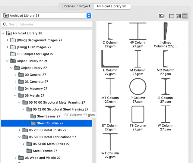

Hi Jeff,
Really appreciate you sending such a clear and thorough response.
Unfortunately, the TS Column 27 and W Beams 27 are 3D objects, not from the DET library. Not sure where they could've gone or what they've been re-named as in AC28.
Thanks again!
AC26 5004 | MacBook Pro (16-inch, 2023) | Sonoma 14.0 | Apple M2 Max | 32 GB RAM
Eduardo Rolon
Mine has it. Are you sure that you have loaded the latest "Archicad Library 28" I think they were not available in the one from Tech Preview?

@Oosh wrote:
I just added the Archicad Legacy Objects and am still missing a number of objects including the following critical ones:
  • W Column
  • W Beam
The W Column 27 is also a 3D Object. The closest equivalent I could find in the 28 Library is the Universal Beams Column (Object Library > 05 Metals > 05 50 00 Metal Fabrications > Steel Column BS), but it is using the BS Standard, not the W Shapes used in the US, so not of much use here.
