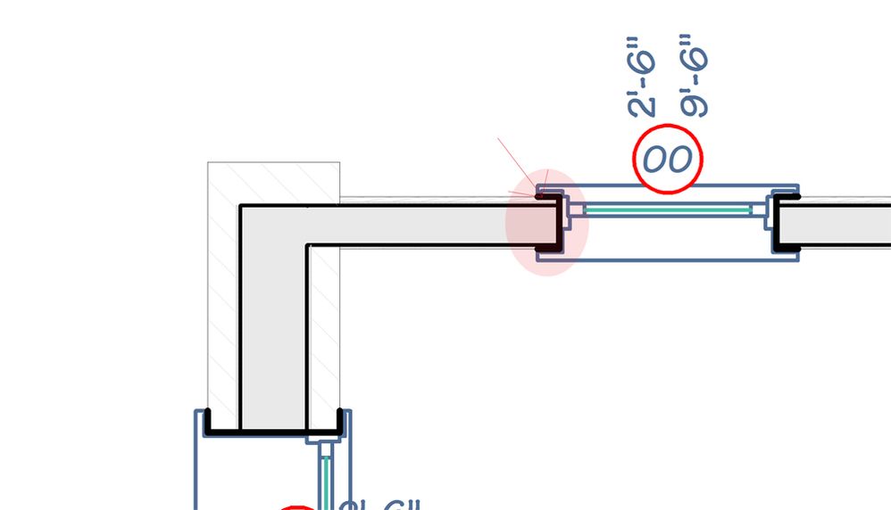

I have looked everywhere for a way to control the line weight of the intersection of Library 10 window / door with it's wall. There is this heavy line drawn at the intersection of wall. As per drawing. I can't get rid of it.

This a bug in the US doors and windows which have fallen behind the INT objects in terms of graphics and user interface despite having some nice features unavailable elsewhere, like exterior casing that can cut into exterior siding. I think the separate development of the US library, while well intentioned is not the best way to deliver features that reflect common North American practices. It dilutes resources and deprives users of what should be mutual benefits. And, as in this case, it makes bug tracking all the harder. Please take a look at my list, published here, that I've been working up with some other committed (or soon to be committed) users and see if you find the same issues. Specifically take a look at Plan symbol-->wrong wall line in the first section.

No. But it has a few of it's own. I encourage all US users to check out the INT library, especially with regard to the doors and windows. Unfortunately they cannot be loaded together.
