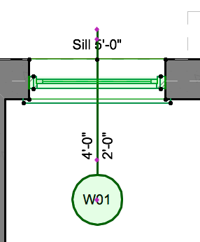

How do I set the bubble W01 to top and the sill to bottom of the wall? I tried the flip but it is flipping the whole window. All I want is to reverse the marker so that the W01 is on the above the window?

OK..I found it in the setting - FLIP

i have found the solution...it's in the marker type and there is a settion in there to flip for marker ...different from the flip for window orientation.

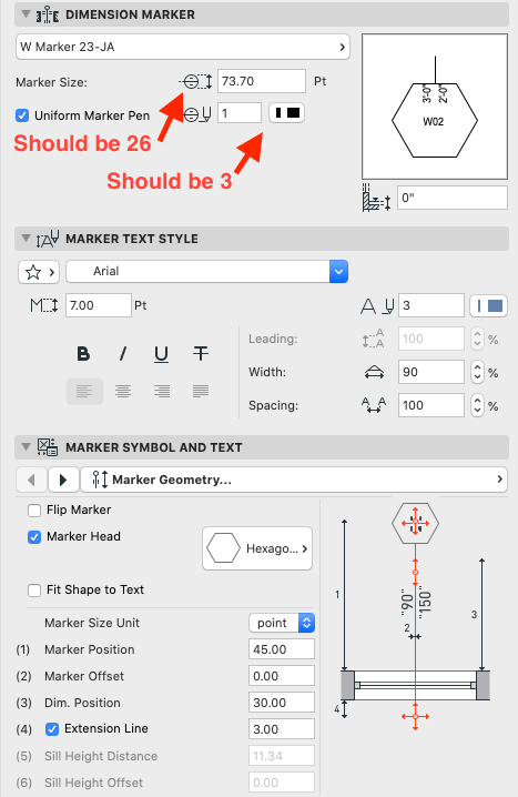

Dave Jochum

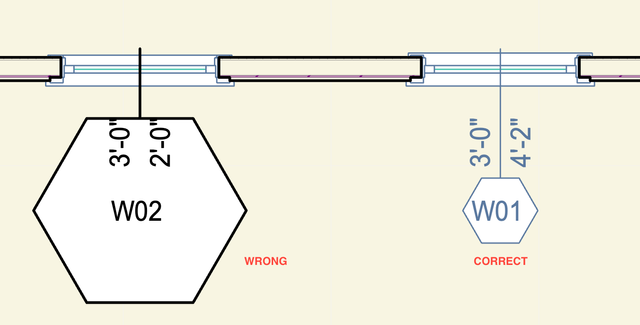

Lazlo,
I've saved the marker and it's always available to choose. The problem is that the marker size is never correct (always 73.7 instead of 26 pt) nor is the pen used (always 1 instead of 3). Every other custom setting is correct--font, font size and width, marker shape, positions, offsets, etc. Even overrides. See images.
