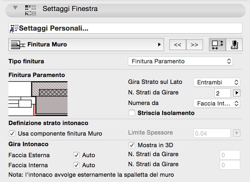

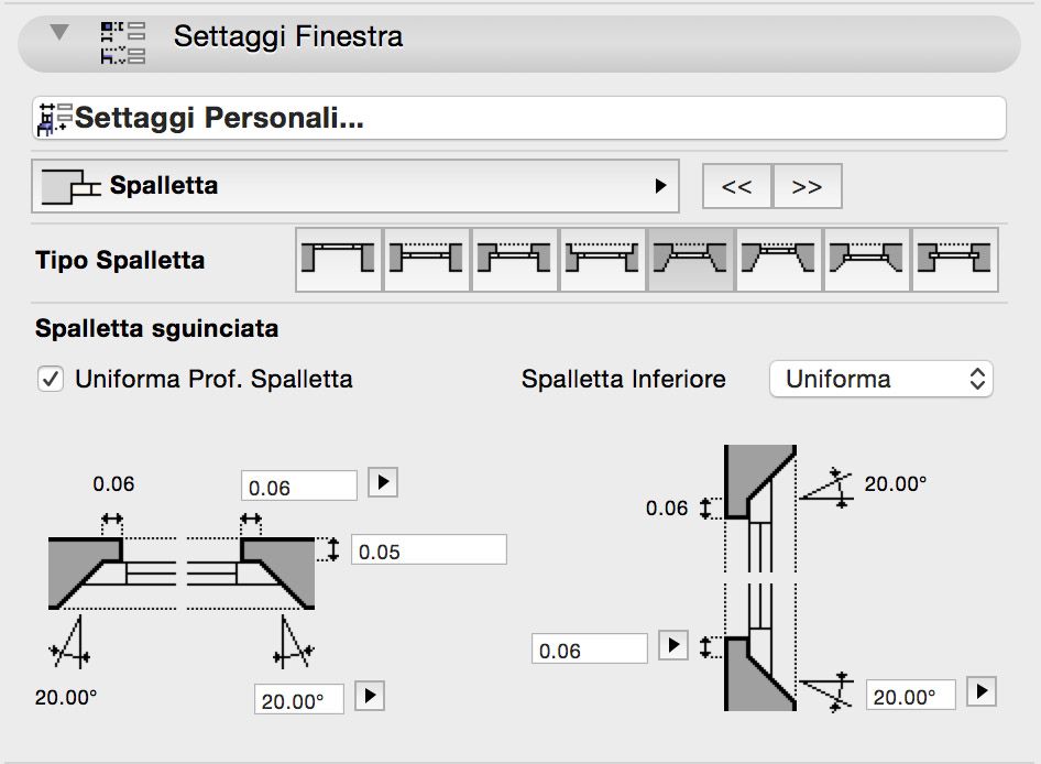

Here are the settings (I'm sorry if it is in italian, but I guess the settings are the same in every language)
Here are the detailed settings for the finishing

The window material is not that important I guess (aluminum). It was the settings of the wall finishing (the ones I posted here) that allowed me to have the various parts of the wall to turn in the opening and therefore get the desired turning of the insulation.
The problem being it works only in floorplan view. You can use the settings I posted and it should work (floorplan only of course)

Found it.
Didn't know you could set that at 'Composites' as 'Type'.
With me it's called 'Core' or 'Finish'.
But also only in de floor plan, not in the section.
In 3D the finish is all around the window.
