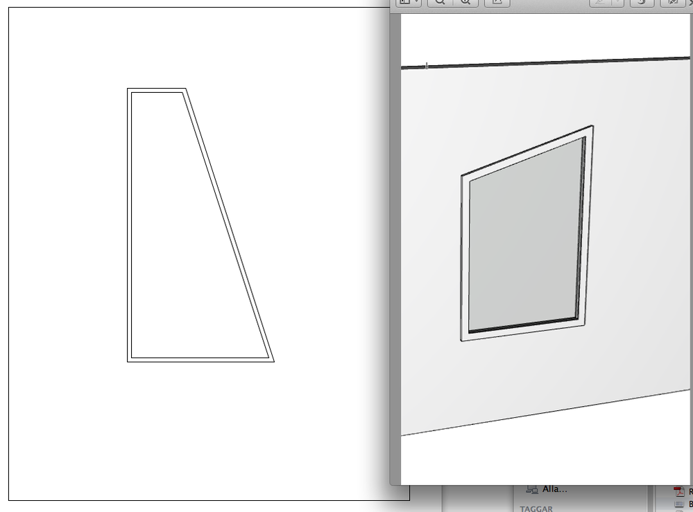

Is it possible to create a window that looks like the picture to the left from the windows in the standard library?
I would preferably like to avoid to create a custom shape window. I got a window that looks like the picture to the right in my library and it would be perfect if it was possible to rotate it, but i guess that's not possible?

Try the FreeForm Window. It's pretty old now but it should still work. https://bimcomponents.com/GSM/Details/8405

Thanks, worked fine!

You can also draw your own design of window.
Creating Custom-Shaped Doors
Saving Custom-Shape Doors or Windows
How to create Custom Window
