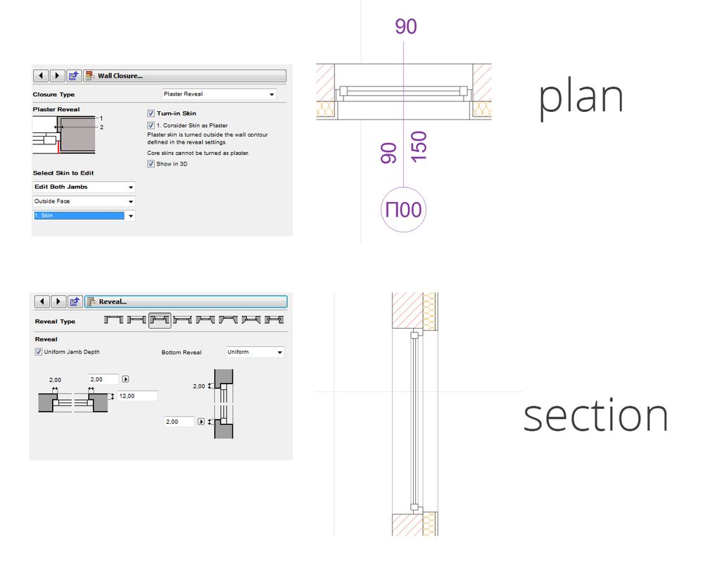

Hello guys. I'm banging my head against the wall last couple of days with this irritating problem:
I want to see the plaster turning around the window in section as well.
Right now I only get the extension of 2 cm coming from the reveal options but the plaster won't turn.
Does anybody has a clue what piece of the puzzle I'm missing.
Thanks a lot!
1 Reply 1
As the saying goes:
It is a feature, not a bug.
Turning those Composite skins is not implemented in 3D, only in 2D.
You best bet is just drawing over them with lines and fills in the Section.
