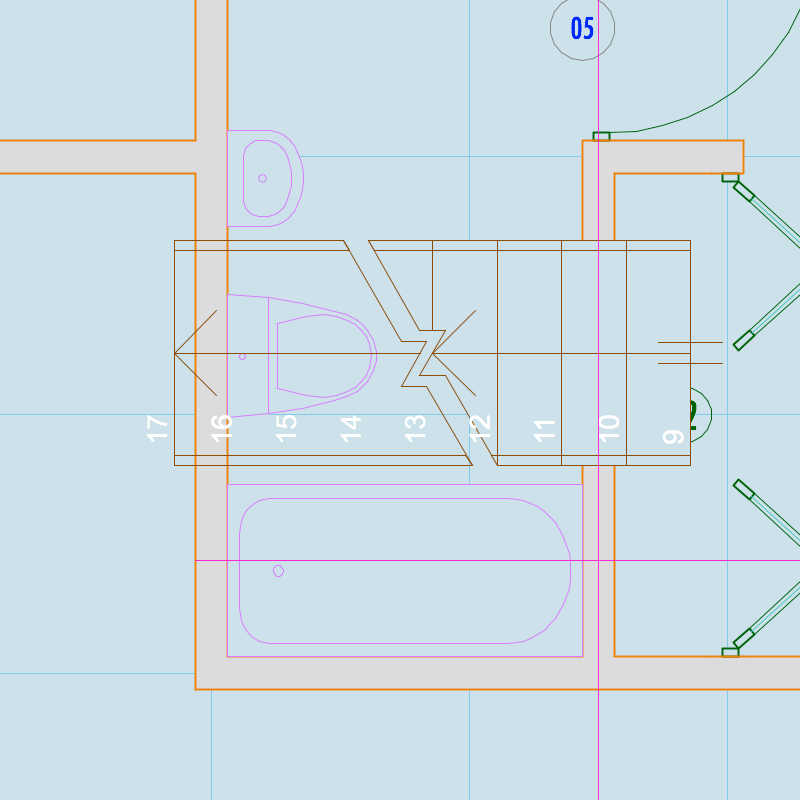

I can't make the upper section above the stair break invisible. I tried changing it in both the selection settings and the open object settings. Both did nothing.

is the object itself set to show on the storey above? you set up 'storey sensitivity' in the stair object's parameters, but you still have to switch on the display of that object on the floor above . . .
HTH
~/archiben
[edit] i see you meant "invisible" after a re-read. same thing, but in reverse - make sure the object itself is only set to display on it's home storey[/edit]

Eduardo Rolon
Check your fill settings

Either way. The stairs are solid and don't show a break at all. I can't figure out what;s wrong. To make things worse now all the walls in the model are gone because of some error message.
Eduardo Rolon
Disappearing walls mean that you either turned their layer off or that you created an invalid object that stopped the regeneration process. For the stairs check your settings under Parameters -> 2D symbol types. If the break line setting is off it will not show, if fills are turned on then what is underneath will be covered. If the stair's home story is below the current one you have to check the stair break line setting under 2D above home story.
