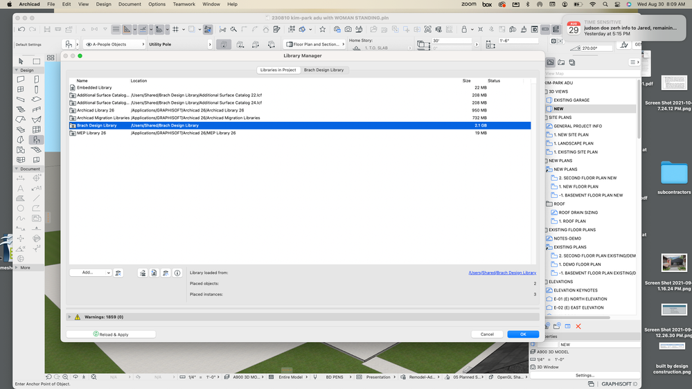

cannot get .gsm to load in library
I downloaded an object ("womanstanding2.gsm"), then exported it to my local drive where my company library is.  But it will not show up in the "objects" folder in the archicad object tool, even though I have clicked "reload and apply" and also closed the file and reopened it.

Dave Brach
Thanks for your responses. I realized that when I downloaded the object it went into the embedded library, and that it would not show in the linked library until I deleted it in the embedded library. So now it shows up fine.

Karl Ottenstein
Moderator Emeritus
Strange!  Wonder if something is wrong with the object?  To check, try (1) just dragging the object from Finder into your model to verify if that works correctly and/or (2) open the object with the GDL editor to see if anything is reported to be wrong with it.

DGSketcher
Legend
If it's a Graphisoft object then it may be linked to called function(s) / data that you don't have in your library. The name you have supplied doesn't appear in my AC26 UKI library, a global search or the AC27TP INT library.
Dave Brach
