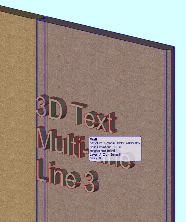

Here is an example of 3D Text (object made by Olivier Dentan).
Works in AC15 too.
And Here´s the object(s) in .zip file:
