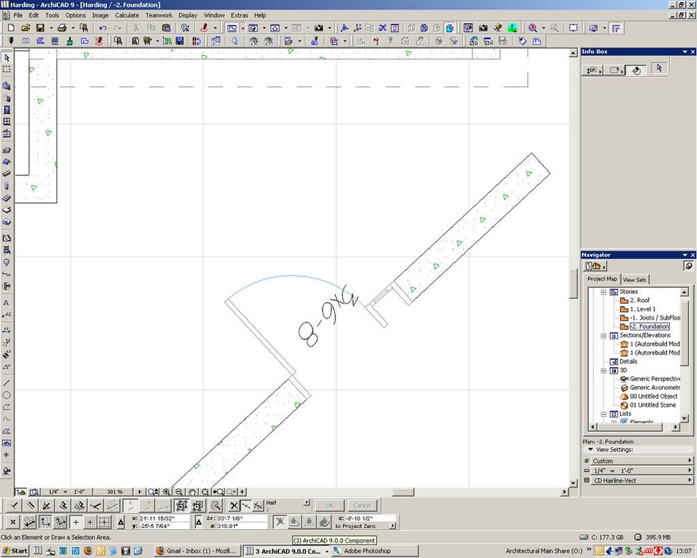

door marker rotation
I have an interesting problem when using the "builder dimension" door marker tool. I'm not sure if this is my error, a bug, or if it's just not capable of doing this... what I'm wondering is, how do I rotate the door marker so it's readable without flipping the plans around in your hands? (see attached)

Did you rotate that wall?
The only way I could reproduce the wrong reading text was by rotating the wall.
Erika

the wall was drawn at an angle, then a door placed in it.
Go to Edit/ModifyWall and select Change Direction. I only know this because I had asked this same question sometime back.

As Don says.........Here:
http://archicad-talk.graphisoft.com/viewtopic.php?p=36688&highlight=#36688
