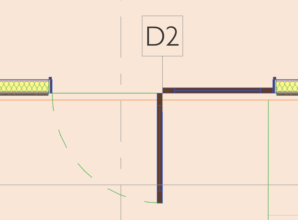

I'm looking for a double door with one door panel operable and center-hinged, and the other panel fixed. I see these generally referred to as swing patio doors - since they are not french doors. Is there something like this in the standard Archicad 11 library? I suppose I could just combine two single doors- But I'm sure there must be what I'm looking for somewhere in the library.

Maybe use a bi-fold door object, but I am not sure if it is possible to set the first pane in a closed position.
Wouldn't it be preferable to have a double opening door rather than a fake fixed panel that looks like a door?
I would rather have a double door and just keep one leaf locked in position (I know the hinge of the opening will not be in the centre).

Oh. So like a 2 panel bifold when you have pinned the first panel rather than the second.
You can sort of do it with the default bifold door object by turning on the End Panel Opening, zeroing the standard opening angle / distance. You will have to manually draw in the opening lines though if you do not want them on both panels. This might be different / not possible if your library does not share the INT doors such as the US library...

The Sliding Folding Multipanel door for the win!  I never would have thought to use a different door type to create this.  Thanks.
Thank you so much for this suggestion. It worked perfectly for what we needed!
