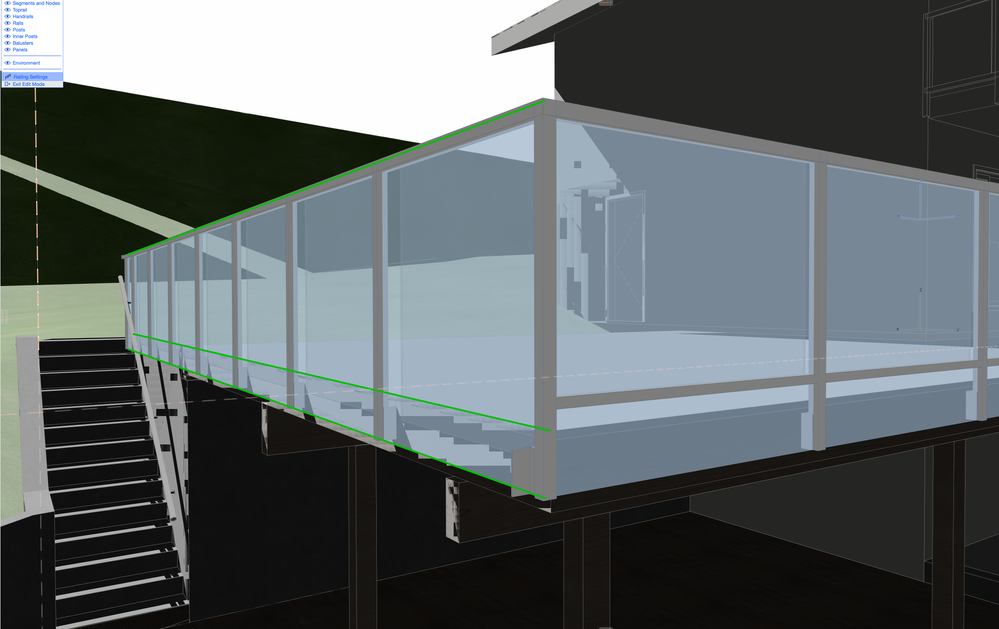

the handrail tool has got to be the least intuitive tool of the bunch. and i think it's buggy. flexible perhaps, but only if you spend faaaaaaaaaaaaaaaaar too long messing around with it to actually figure the stupid thing out. it seems that the changes you make through the settings dialogue of the tool don't always make any difference, which i don't understand, and if you go through the edit > railing settings pallet it may make the changes that you just tried in the settings dialogue. REALLY! two ways to do it, yet inconstant results. one tool, one bloody settings dialogue please! now, i have the railing in edit mode, i select the one segment, open the settings dialogue from the edit window, make some changes to the selected segment and Ta Da! the segment does not change, but the adjacent one does. WTF. yep, that's helpful and intuitive. you can see the segment i have selected, and the next pic of the dialogue for that segment with the bottom rail addition for that segment, but it doesn't match what's selected, but you'll see that it's the adjacent segment now has the bottom rail. i'm sure there's a reason, but that's just it. it aint intuitive.

I am not Graphisoft, but I will see if I can pass on some of my knowledge.
If you use 'Edit' mode on a railing, you will be changing just that portion of the railing, and you will see those little yellow warning triangles to tell you that those parts are not consistent along the entire railing.
So you have done an 'Edit' and changed just one part of your railing - it will no longer act a one overall railing.
Now in your image you have selected that particular segment of the railing.
But it appears you have gone into 'railing settings'.
Railing settings apply to the entire rail, but not to the segments you have customised (otherwise you would have to re-customise them).
That is why the adjacent segment alters - because it has not been customised - but you are applying overall railing settings, so it will change.
The custom section remains un-changed.
If you want to edit that, then use the settings button in the info box.
If you select the segment, you will see segment settings in the info box.
If you have selected just a post or a rail or a panel, you will see just the post or rail or panel settings in the info box.
If you don't want 'custom' parts in your railing, you can select that part with the yellow warning triangle and reset it back to standard.
Those parts will adopt the overall railing settings.
So, I would recommend that you don't use 'Edit' mode, unless you need to change an individual post, or make one segment higher, or change just one of the panels.
I hope this helps.

Thanks Barry, that does help clarify how the settings menus work however the path you described is not netting the results you suggest it should. Next week i will make a movie of the process and the results actually get or don’t.
