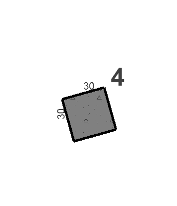

I have a problem.
I made a label for columns for structural representation purpose.
My question is the following: How can I get the rotation angle in plan (along its axis) of a column? I need this datum in order to write automatically parallel to the sides of the column the dimensions of it ...
Can anyone help me, please? Any suggestion?

I have hundreds of columns placed in plan with different rotations. It's a big job to rotate the labels one by one!

...but there's a big problem.
This method works only if you rotated the column modifying the value of that parameter ... and that value doesn't change if you rotate the column with the rotate tool!!!!!
It's strange. In fact, if you rotate an object with the rotate tool, that parameter (for object) changes... for columns it doesn't happen!
