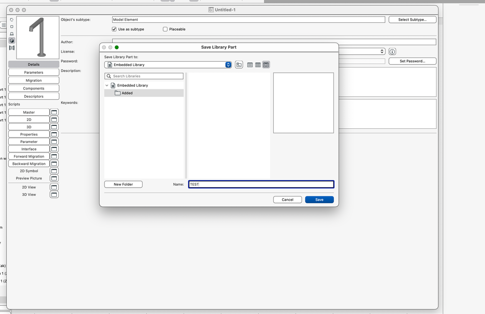

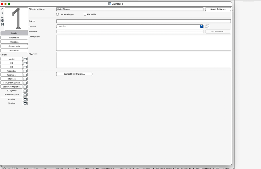

Hi! This is how I understood is to important 3D Dwg into an archicad...
I downloaded from manufacture 3D Dwg file - my only goal is to use that file in my project. Nothing else. For some reason there is long workaround in order to load this piece in archicad, or even save it and find it in library.
I found manual here on how to open raw dwg as 3d: File > Libraries & Objects > Open object .... I got here..
Now I see infront  of myself the Object details ... But nowhere to rename it/save it bottom? The only another workaround I found is to close the windows and it would ask me to save if first before closing.... I rename it, but then it says unable to save without choosing license. Options are below. I don't care about license, I don't want to share it, I just want to use it in my plan. which is why I downloaded it. No matter what license I choose, I can't successfully save & find the object. When it finally somehow let me, it won't show in embedded library even it is there. just nothing. I am exhausted.
licenses;
Public Domain Dedication
Attributions no derivs
Attriution 4
Attribution share a like
Attributions no derivatives
Commercial
there is explanation for each but no matter what I choose (and again I don't want to even share it, I just want to USE it since thats why I downloaded it?)
I am completely lost here. This is just so overwhelming. All I want is to use the file I downloaded.
Operating system used: Mac Apple Silicon 14 Sonoma
MacBook Pro, Sonoma: 2.6 GHz 6-Core Intel Core i7, Intel 16GB mem,
Archicad Solo 26 and 27 (in testing mode)

Solution
AllanP
you should tick the "Placeable" object option, to make it visible in the objects list.
with this unticked, it acts as a macro that can be called by other objects, but can't be seen in the objects menu.
To save a library part
when the library part window is the active window
you use the file menu File >Save
or
File>Save as
or
you can use CMD + S
then the save library part dialogue comes up instead of the normal save project dialogue
I hope this helps.
