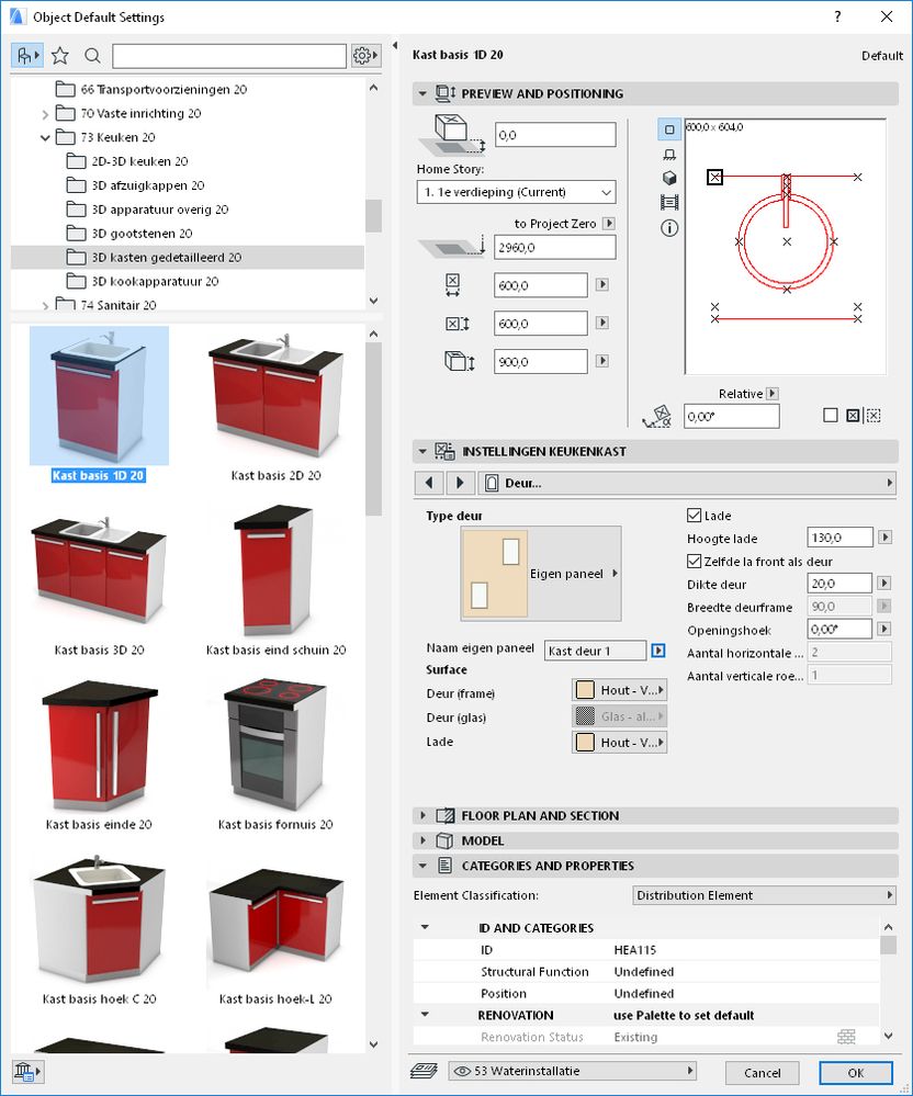

Erwin Edel
Rockstar
This is where they show up. They are not objects you place in floor plan.
Excuse the Dutch, but I do not have INT library to show English, still the pictures used by UI should be the same.
