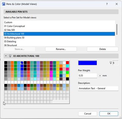

so that is in my pen set.

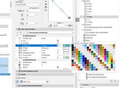

 and thin is showing in my pop-up  windows

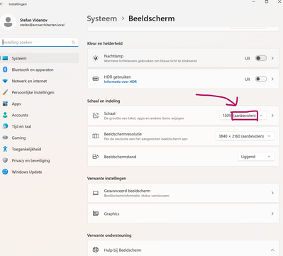

Hi Thorr,
This happens rarely when you have a non recommenden windows UI scaling.
Try changing the scaling of your screen to the recommended value, and if this doesn't work try upscaling or downscaling.
