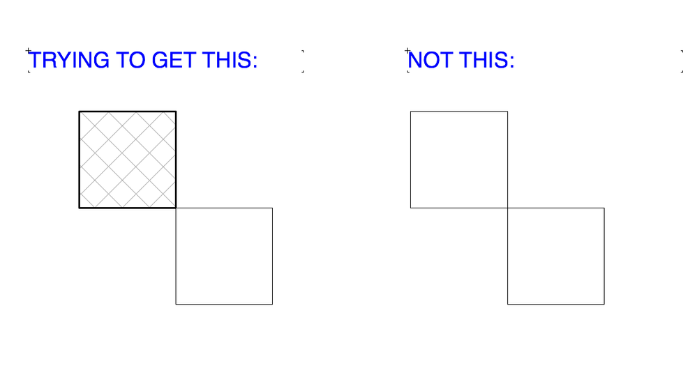

I've just started down the path of scripting my own objects, and I'm simply searching for a way to make the regular plan 2D view of the object look as it does in the Section or 3D Doc/Plan view.
I've attached an example file of what I'm trying so far. The upper block would ideally be filled with a user selected cut fill and the lower block would just be outlined.
(Basically the way I would want every object to be displayed by default, cut at the level of the floor plan view)
Thanks!

Ok, that makes sense. After playing around a bit more it seems that objects cut with a CUTPLANE do not count at cut polygons in PROJECT2{3}....?????
Changing the 4th parameter between 3,12 and 15 shows that the shapes are not recognised as being cut.

Thanks Pertti, that was a really helpful script - it seems to do everything.
For the moment I will stick to something a bit simpler, the key information was that it appears that CUTPLANE{2} has to be used to generate cut polygons - I had no idea.
As soon as I switched CUTPLANE for CUTPLANE{2} 0,0 it all looked good.
