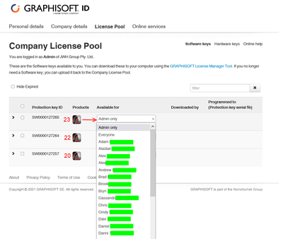

I don't use software licenses, but I thought the person set up as the company administrator could allocate which license could be borrowed by which user in the Graphisoft ID controls for the company licenses.

I do have software licenses, but as I said I don't use them.
They are for old versions we no longer update.
It seems I can allocate our company users to a particular license.
So @drewcaddy , maybe you can assign your AC22 users to have access only to the 22 software key.
The problem is, if you have more AC22 users than licenses they won't be able to use a 26 license unless you allow it.
And if you allow them to use the AC26 licenses, you might be back to square one.
Then you will have to manually control it in the Codemeter Webadmin page, and kick AC22 users off the 26 key so AC 26 users can log in.
