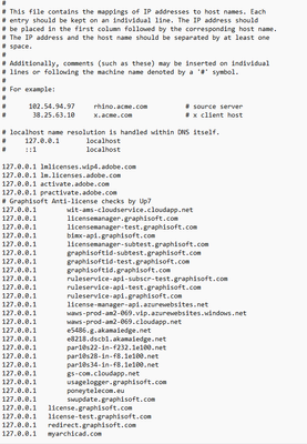

Hi, at windows 10 - problem was solved by advice from @Minh Nguyen
1 go to: C:\Windows\System32\drivers\etc
2 open Hosts (with wordpad or notepad)
3 delete all lines from # Graphisoft Anti-license checks by Up7 till the end. Once you're done, press Control + O to save the changes.
4 close editor ( Control + X )

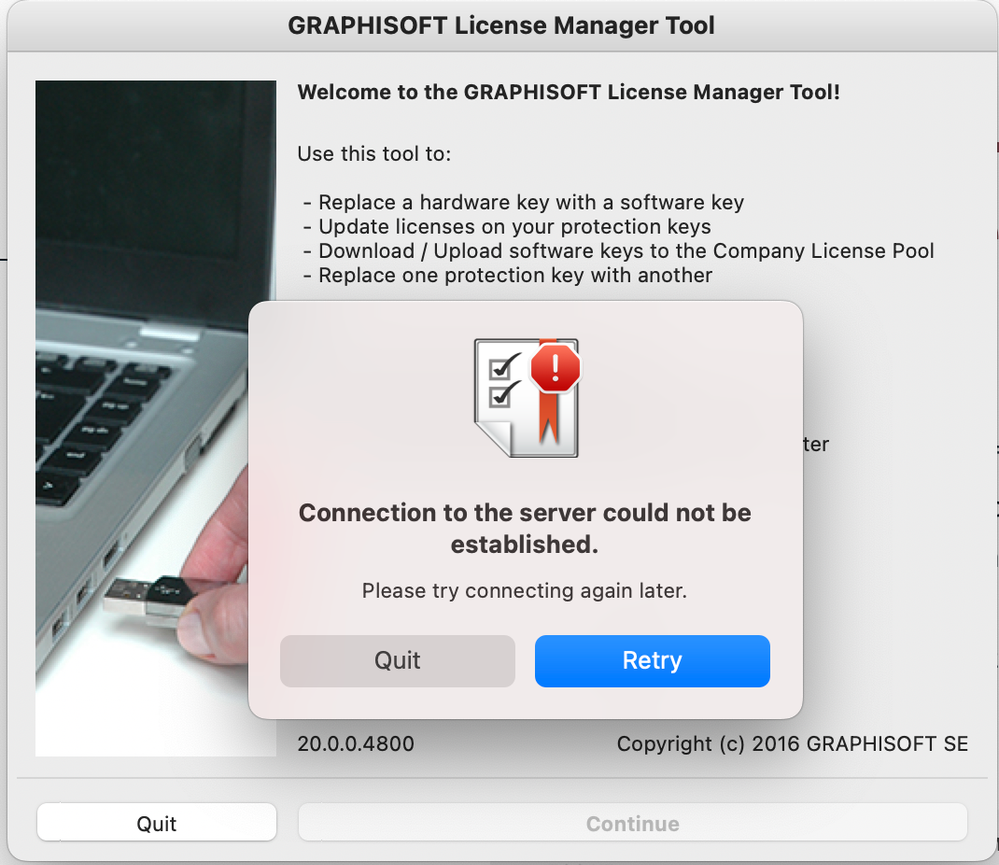

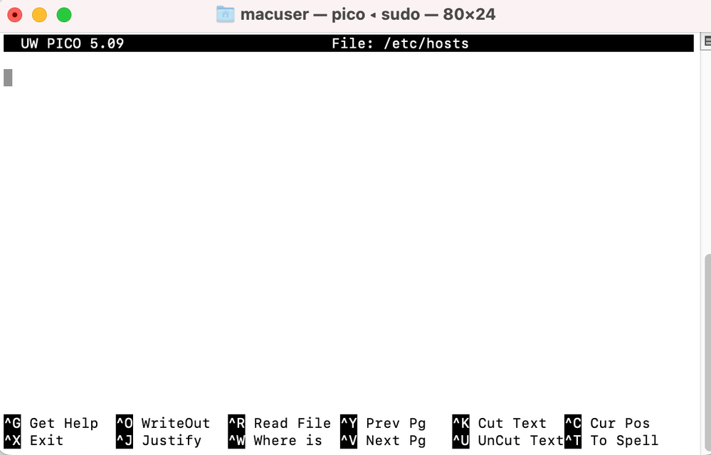

Hallo, I have the same problem. I have attached 2 screenshots of my terminal and licence manager tool.  Please help:)
Thank you in advanced!
