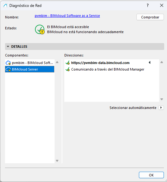

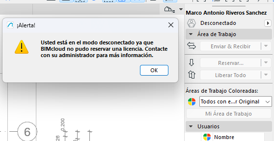

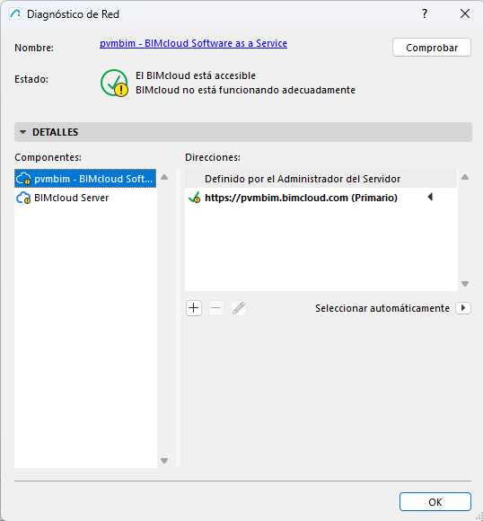

marcoariveross

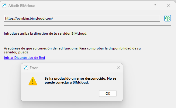

Enough with all these problems... how are we supposed to recover the man-hours we're losing?
I've attached screenshots of what's happening. It's completely unusable.
Enough with the same old excuses: "It's the files," "It's the size," or "It's the configuration," when it's a deeper issue with Graphisoft.
I'm providing screenshots to show that it's not just one server, but two that I regularly work with and collaborate on.
We need real solutions.

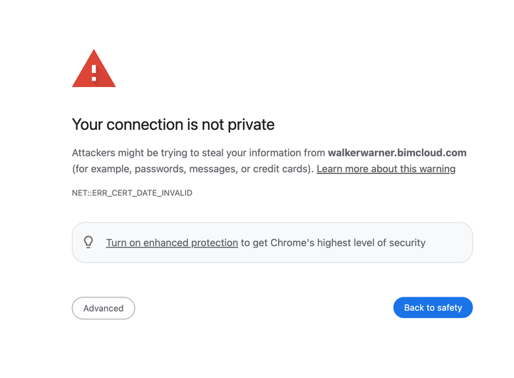

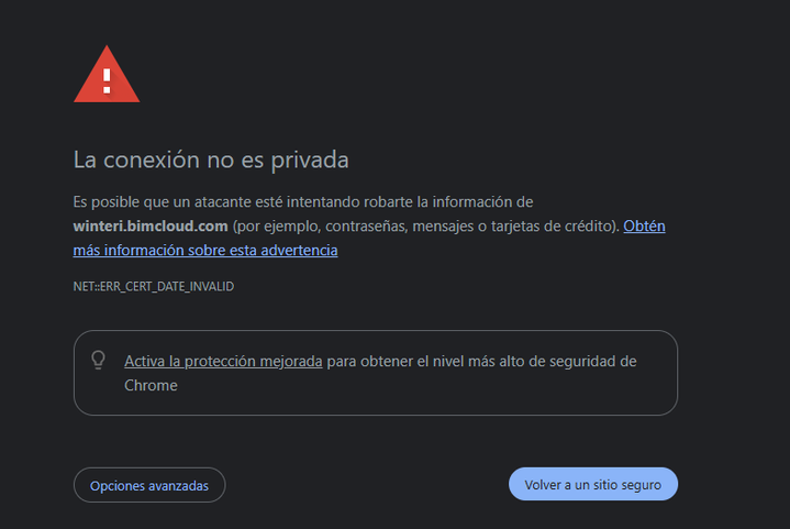

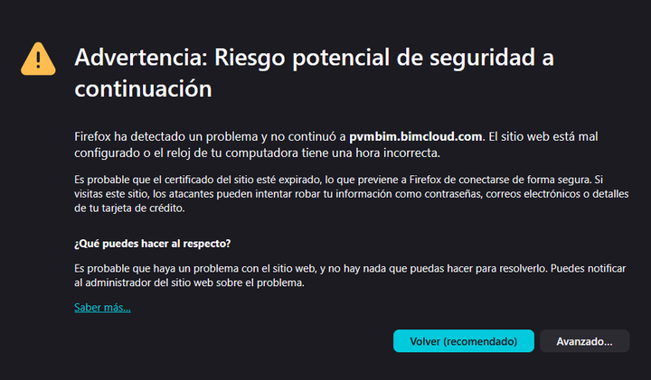

We are currently facing the same issue on BIMcloud SaaS.
This is affecting multiple BIMcloud domains on our end, and the issue persists across different networks (including users working from home), so it doesn’t appear to be a local firewall or antivirus problem.
Seems like a server-side SSL certificate issue. Would appreciate any update from Graphisoft on this.

Looks like the issue has been resolved now.
www.bimvizstudio.com
ArchiCAD Service
ArchiCAD since v9 to latest
Mac, Windows 11
Here is some info about what happened:
https://community.graphisoft.com/t5/Graphisoft-Insights/BIMcloud-SaaS-Service-interruption-on-March-...
Yes, it should be back to normal. Or, you may need to
  • Restart your browser or Archicad
  • Clear cached data (this helps your system pick up the updated certificate)
