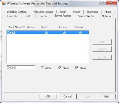

Server side
From the server side in the WIBU control panel in the Server access page can be controlled, which clients can be accessed to the server. In the list is a default setting, that controls the servers ground function.
Beside the default entry clients computers can be added with IP address and with the computer's name and give different authorities to different clients. On the bottom part of the panel the authorities can be set with pipes. Read: client can read the content of the WIBU Key on the server Access: client can reserve an empty license on the server Cancel: client can fire another users from the server with the help of the server monitor. ( WkSvMon )
NOTE: any changes has been made in the WIBU control panel can be verified only when restarting the WIBU server.
