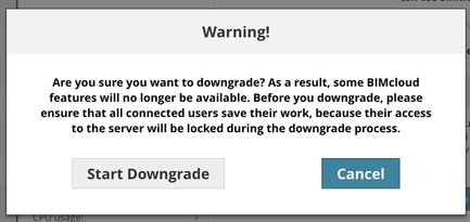

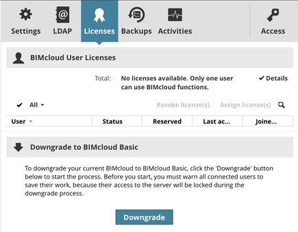

Initialize the Downgrade Process The downgrade process is started under the BIMcloud Manager License panel,
to which a final warning will be presented.

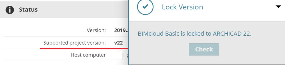

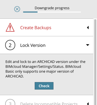

2. Lock Version While BIMcloud supports multiple versions of Archicad client data, BIMcloud Basic can host only one version of Archicad.
Similar to all of the steps to follow, a check provides feedback about why a step is not complete. Here the downgrade assistant warns that the supported version was not entered and shows where the change must be made.
BIMcloud Basic can support only one version of the possible version options: 19, 20, 21, 22 or 23. To change the supported project version, hide the downgrade panel by clicking on the panel tab shown below. Once you need to see the downgrade panel again click again on the tab.
wp-content_uploads_2017_10_Warning_18x18.png WARNING: This is the last time you can modify which Archicad version you would like BIMcloud Basic to support. A successfully completed step will have a checkmark and its box will be greyed out.

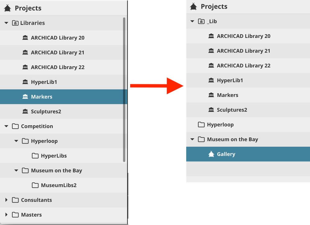

4. Move Projects The project folder hierarchy of BIMcloud Basic allows for only a topmost level of folders.   Steps 4,5,6 are part of the process of flattening out the BIMcloud project hierarchy in preparation for BIMcloud Basic.

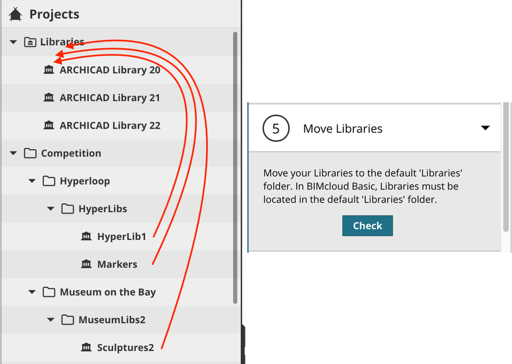

5. Move Libraries In the below example, the libraries found in the folders are moved, since BIMcloud Basic does not support project libraries or for that matter the sub-folder hierarchy. After v22 project libraries have been moved, the projects that reference the moved libraries will need to have their library links manually updated to the new location.
Archicad versions older than v22 exclusively use the default library location, so this task of moving project libraries in sub-folders is only pertinent to v22 (or above) projects.

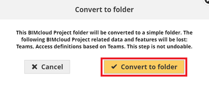

6. Eliminate BIMcloud Projects BIMcloud Projects are special folders, which are not available in BIMcloud Basic. Before you can continue with the process, you must convert your existing BIMcloud Projects to regular folders.
To convert a BIMcloud Project to a regular folder, you need to select the BIMcloud Project and in the appearing menu, under More, select Convert to folder option.
A warning will appear to inform you about the consequences of the convert process. Select Convert to folder option to finish process.

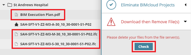

7. Download then Remove File(s) Files, such as PDFs or IFCs, must be removed from BIMcloud Server before the Downgrade process finishes.
It is recommended to download these files first, then remove them completely from BIMcloud to finish this step.

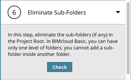

8. Eliminate Sub-Folders The project hierarchy is flattened to a depth of one folder. Folders used to store project libraries are removed.

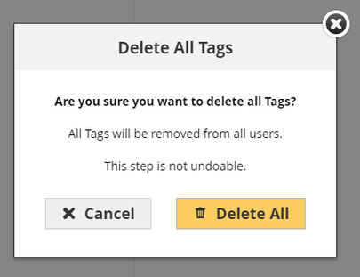

9. Delete All Tags If any of the users applied the Tags feature, the downgrade process will remind you to delete all tags before you can complete the process.
Select "Check" to activate the "Delete All Tags" dialog.
Select the option "Delete All" to delete all tags and to be able to continue the downgrade process.

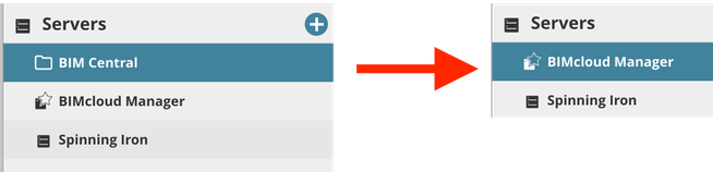

12. Move BIMcloud Server Using folder hierarchy for managing BIMcloud components, such as BIMcloud Servers, is not allowed in BIMcloud Basic. BIMcloud Server must be moved back to the root on Servers page of BIMcloud Manager. More information about how to move BIMcloud Server can be found in our BIMcloud User Guide.
13. Move BIMcloud Manager Using folder hierarchy for managing BIMcloud components, such as BIMcloud Manager, is not allowed in BIMcloud Basic. BIMcloud Manager must be moved back to the root on Servers page of BIMcloud Manager. More information about how to move BIMcloud Manager can be found in our BIMcloud User Guide.

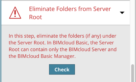

14. Eliminate Folders from Server Root Similar to the project folder hierarchy flattening process, the Server Root is flattened in previous steps. With BIMcloud Basic the Server and Manager must be hosted on the same machine. In the process of disconnecting BIMcloud Servers it is important to keep the server that was installed on the same host machine as the BIMcloud Manager. In the below illustration the final BIMcloud server, the one that was installed on the same host machine as the BIMcloud Manager, is still left in its containing folder. Since the Server list in BIMcloud Basic can only be a flat list, the “Spinning Iron” named server must then be moved to the same level as the BIMcloud Manager.
Then the “BIM Central” folder must be removed.

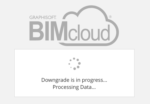

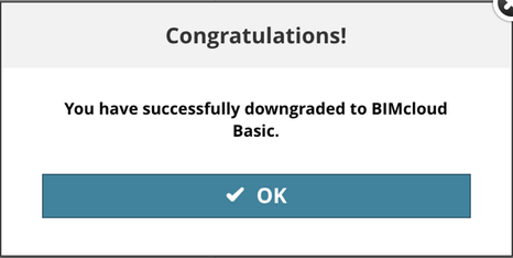

Finalize the Downgrade Once all 16 tasks have been checked for completeness the downgrade can be run. This process may take a few minutes and while it is running any user who tries to login to the BIMcloud Manager will be presented with the following notification:
After it is has completed the following dialog will appear:
Then the following BIMcloud Basic activation panel will be presented.
After activation has completed the downgrade is complete.
