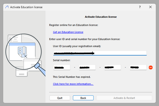

My serial number education has expired
horewa
my student license expires on August 7, 2027, but in the picture it says it has expired which should not be expired, then I found an article from graphisoft itself about this case and there it was told to update archicad to version 27.3.4 or 28.2.0 and I have updated it to version 28.2.0 and even to 28.2.1 and still the result is that my student license has expired.

I thought student licenses were only for 12 months (I could be wrong).
If the license has expired, it won't matter what you upgrade to, it still will be expired.
Have you applied for a new license through the MyArchicad website?

Hi @horewa ,
Since your issue is with a school type license, I suggest you contact myarchicad@graphisoft.com with your problem and they can assist you with the next steps.

There is currently a problem with EDU licences which expired after 23rd of March (or something like that) and it is an bug in AC27 and 28 (as well asi in older).
AS @Noemi Balogh wrote, write on the email to get you a new license.

Hi there,
Thanks for positing this here. It seems like your problem is connected to a known issue, please check our article about it here: https://support.graphisoft.com/hc/en-us/articles/36796394374161-Fixing-Archicad-startup-and-license-...
We usually recommend to check our Support Site first for self-help troubleshooting, most of the issues are covered there, which can lead to a quick and easy solution. If you don't find the answer to your question, you could also ask this question from our support team by submitting a request on the Support Site.

thank you for the link provided it really helped me, and from the graphisoft team it helped quickly and clearly, they guided me until finally I got a new serial number that worked.
