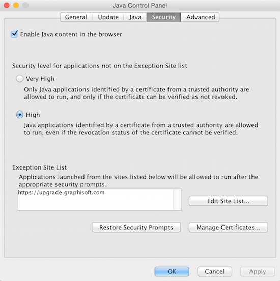

  6. Add https://upgrade.graphisoft.com to the Exception list on Java Control Panel/Security

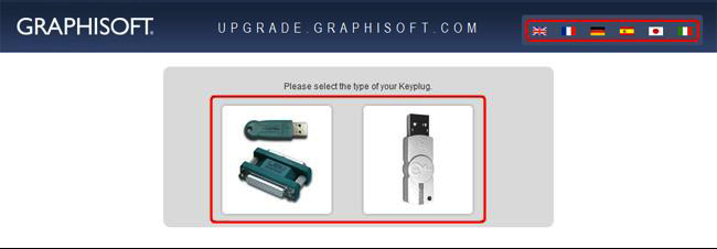

  8. Select the preferred language.
  9. Click on the image of the key you have.

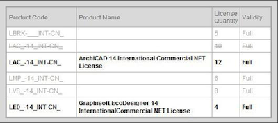

  11. In case your selected keyplug is empty, the recently purchased license will appear and be available for programming. Click Upgrade/Load Selected keyplug button at the bottom of the page.
    In case your selected keyplug is already programmed, the current content and the content after this programming will appear on the page. Click Upgrade/Load Selected keyplug button at the bottom of the page.
