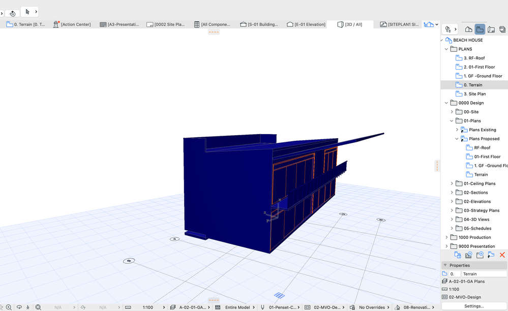

Hi All
I Wonder if you can help, I am currently studying through archicad and all of a sudden my 3d view of the house and all materials has gone blue? Has anyone had this before? Really need help on this one!

Is it the active Renovation filter?
I see you have no Graphic Override active, but the reno filters can override surfaces too.
