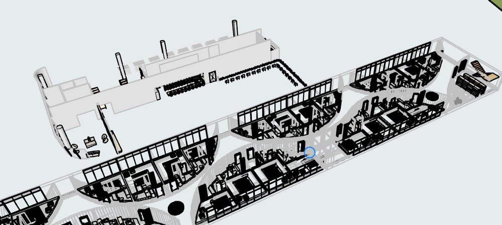

I`m having a problem with my 3D and would like to know if this is a bug or something that I did by mistake.
Half of my 3D is showing in the wireframe style and half is showing with the normal basic shadow style.
I tried to change the style, changing the floor of the 3d lines elements, reset archicad, throw in another document...
The 3d is also really show and always updating, but is not heavy at all
Ps: is not only one element, all the group (obj, slab, windows...)
The picture shows the building above with the normal 3d style and the below with the wireframe one.

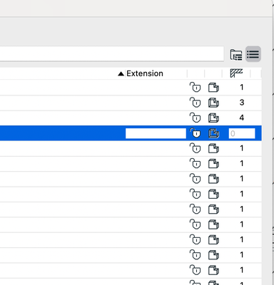

Did you make a layercombination with certain layers as wireframe?
