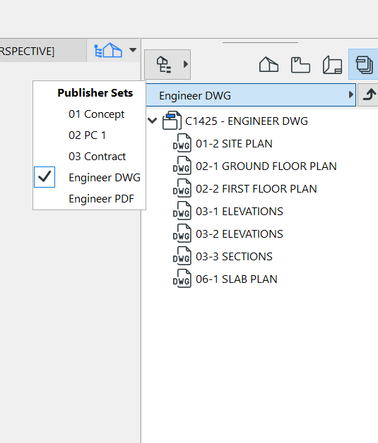

Hi, I'm having an issue with Archicad 26. When opening jobs, some from Archicad 25, others started in 26, I've had the file crash for seemingly no reason, I'm sometimes not even in the job, and I get an error message that says 'A serious error has occurred while processing the project data. Archicad must be close.' The only options are quit or repair (Archicad will restart). No matter what I select, it simply quits. I'll then get that error message on start up, resulting in a crash loop.
I was wondering if anyone knows why this is happening or how to fix it, because open and repair doesn't always work.

from what I've seen we have had a few different machines have the crash when changing publisher sets.

I did "open & repair". This solved all issues related to this for the moment.

‎2023-02-02 01:19 PM - edited ‎2023-02-02 01:20 PM
Talked to our local reseller, they contacted the developers, and we might have a fix next update.
This problem is really killing all the fun in working...
Edit: In one of our files it had something to do with one of our client specifik DWG translators.
