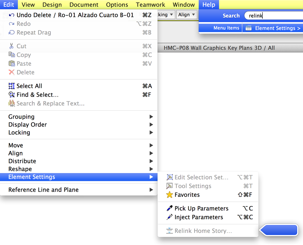

Eduardo,
Where is this Relink Home Story command? I have yet to find any way to change elements' story assignments without them jumping around.
My subscription is up for renewal this month and this has me questioning whether it's worth it.
Eduardo Rolon
Here
Eduardo Rolón AIA NCARB
AC29 US/INT -> AC08
In addition to the usual places, it is in the context (right-click) menu.
