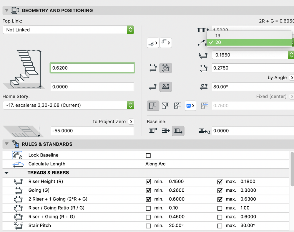

AC 25 4013 stair tool driving me nuts
I change the stair height to 0.62 and the list of available risers doesn't update. If anybody can figure out what's going on I'll be very grateful, because I've just wasted quite a bit of time on this.
2 Replies 2
Hi Ignacio, I think if you uncheck the ( Riser height & 2R+G ) check boxes it will update the number of available risers.
AC 29 INT 4006/WIN 11
Patrick M
yeah, I never use the "rules and standards" checks, since they just trip things up. As long as you are setting your riser/tread ratio to something that meets your code, you don't need the tool to define that for you
